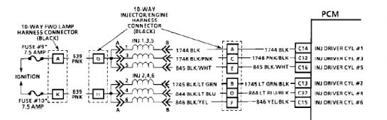

    So this is the one you don't have hooked up?
    It looks like the one that connects to the injector sub-harness, but I see it isn't.
    OH! You know what I bet that is? Power for injector bank #1 and #2. That connector probably would have gone to the fuse box. That's why I don't have it, I had a fuse block on my harness already.
    Unplug your injector sub-harness and see if you still have continuity to C12-16,32. I bet you won't because you're getting the continuity through the injectors.
    Throw a 10-amp fuse on each of those pink wires connected to an ignition switched source (make sure it's still hot when cranking, some aren't). I bet it'll start!
    Alright. I will try that tonight. I'll post back once I check that. Feel free to post any more ideas until I try that out. Thanks for the suggestions.

    Do you have 12v on the injector plugs with ign on?
    So are you saying the Injector Drivers aren't connected to anything?
    What does the loose connector look like?
    I have several loose connectors. The one that has the two pink wires I am talking about is black/grey. I have the harness by the injectors plugged in. I am wondering about the two pink wires in the connector that I listed.

    10 Pin Grey/Black
    Pink- C12,C14,C16 Injector Drivers Cyl's 3,1,5
    Green/White- B6 A/C compressor clutch Relay control
    Green- C2 A/C Clutch status
    Brown- B3 Secondary air injection system air bypass solenoid
    Brown/tape-B11,B12,B13 EGR# 1,2,3 control
    Pink/tape- B20,B32,A6,C17,C20,C21,C25,C31,C1
    Green- Same as Pink/tape
    Pink- C32, C15,C13 Injector driver Cyl's 4,6,2
    Maybe the problem is I do not have ^^^ these pink wires hooked up? IDK, my harness is plugged in at the injectors at the fuel rail?

    10 Pin Grey/Black
