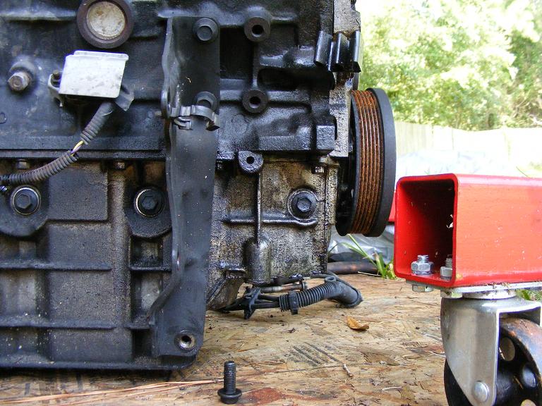

      I'll start off with what I thought would be the biggest issue : engine mounts. The front mount on the 3400 has the same function as most 60* motors I have seen; it holds the top passenger mount and has holes where the A/C is located.
      The top holes for the A/C compressor (bottom of the bracket) are different on the 3500. They protrude about 1/4" further than the 3400. I shaved around 1/8" off of the bracket in the pic above. I'm going to wait and grind it down a little at a time until it matches up perfectly on the new motor. I'm waiting on parts before I can mount my heads and start test fitting the pieces before I shave any more off of the mount, but It looks like it will work. I measured everything out and see no reason why all three A/C bolts wont work. I have heard of issues with the bottom bolt not lining up but from what I see that should not be an issue. With the 1/4" taken off the back of the bracket to mate up with the 3500, the front of the bracket should be oriented exactly like the 3400. The bolt hole on the oil pan seems to be in the same spot on both engines.

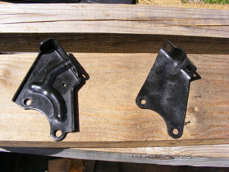

      Here is a comparison pic of engine to trans brackets. The left is from the 3500 in a G6 and the right is off of my '89 Cutlass Supreme. They are very similar but the holes are slightly different. The next picture will tie this all together.
      Here we find that the Venture bracket is completely different from the others. The two brackets from the previous pic mount in the holes towards the pulley side, and those holes are in a different spot on the 3500 compared to the other 60*V6's. However the Venture's bracket mounts in the other pair of holes which are in the same spot on the 3500. If you notice it extends down and bolts to the oil pan. That bolt hole is about an inch off on the 3500. It probably would work without it but I have a few ideas to attach it. I might hack a piece of metal off of the G6 bracket so I can bolt it to the oil pan and then bolt the new metal tab to the bracket. I would have to grind the mounting boss on the 3500 oil pan down by an amount equal to the thickness of the piece of metal I am adding. I had other ideas but I don't want to put a hole in the oil pan or have to get a nut welded to the pan if it can be avoided.
