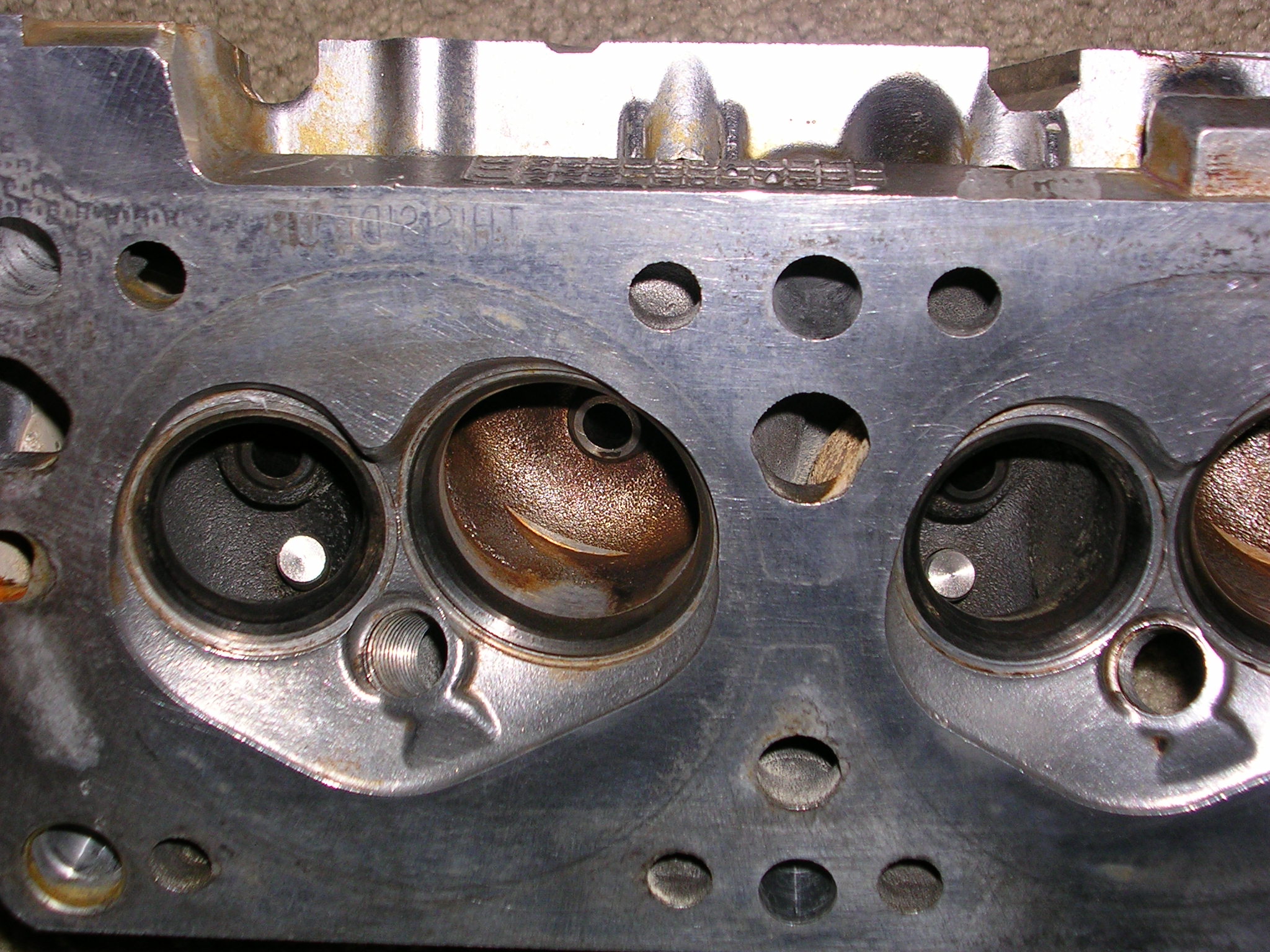

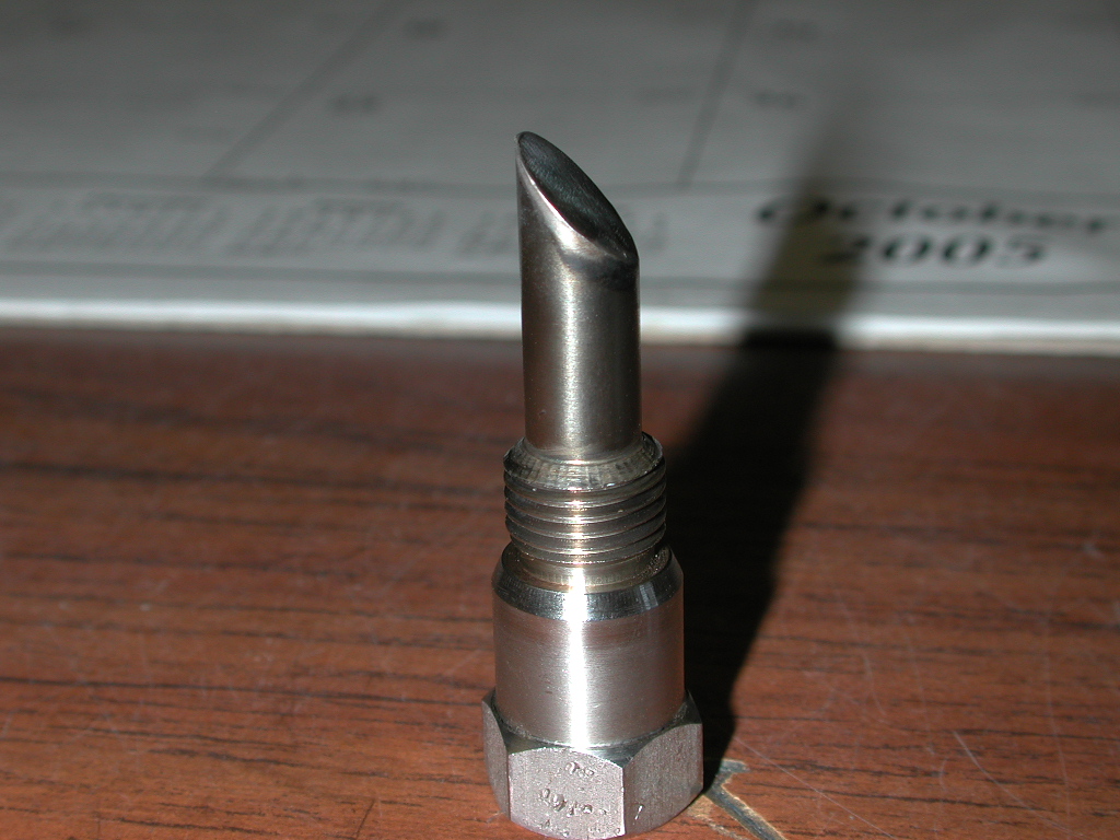

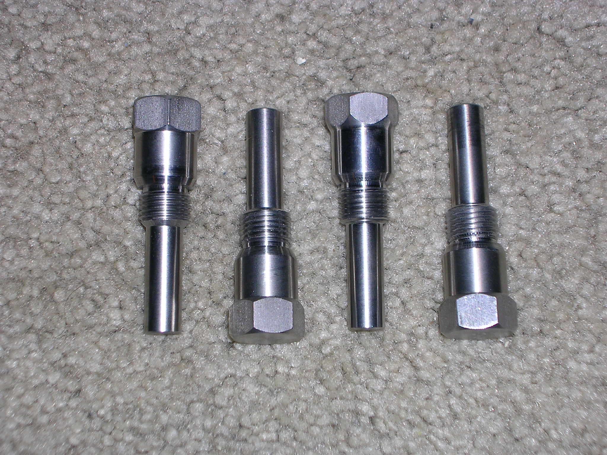

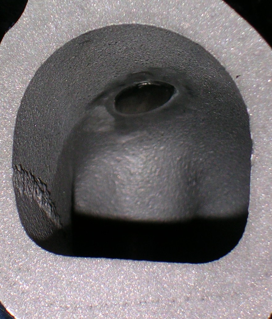

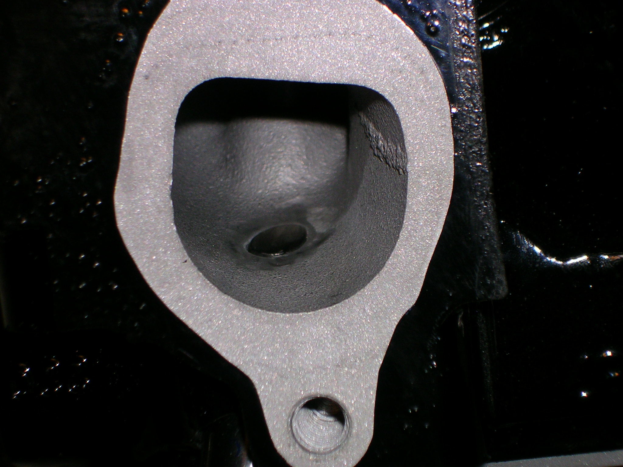

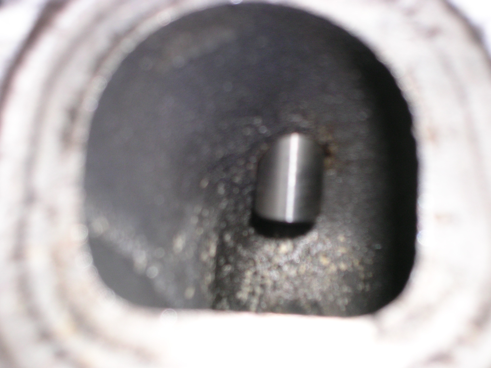

                Yes air system goes into exhaust ports, 2 of the three to add more oxygen to the mix to make the converter work better, and yes it only runs for like 10 min at first startup.
                Let me find the pix of what I did to my air heads to make them work on a non air car.
                Edit, Images
                I realize my post is irrelevant tho, since you are putting a non air motor in a air car... so um yeah, my parts dont help no one. LOL
