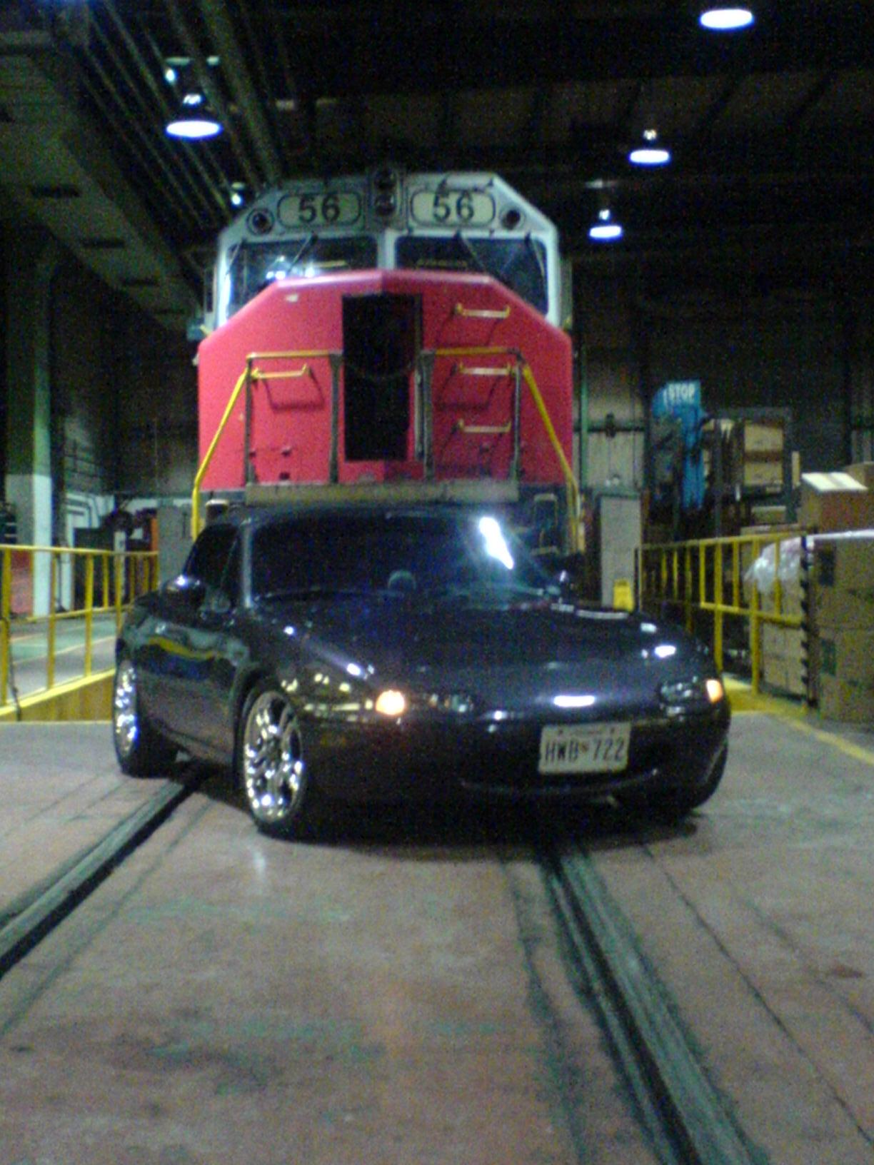

Name:	cell 1 301.jpg
ID:	379180Hi guys. I know i'm gonna catch some static on this one, but here goes. My turbocharged 4-miata just isn't up to snuff (no torque). While I love the car for all of its merits. Just doesn't have what the car deserves for power. That said, I also love the 60-degree chevy...always did. I had one in an '84 camaro w/a 3.1 (ol 2.8 snapped 2 cranks) a 4-barrel, wolverine cam, headers, 5-speed, and 3.73 gears.....let me tell you in that light car I ran with stock 5-L mustangs and beat,no killed many a 305 camaros. That was back in '94. I KNOW what these engines are capable of. Now for the juicy part. Does anyone here know if the 3900 block will accept the iron heads? You probably know where i'm going with this. I also know that a custom bellhousing is available for the transition to RWD, i just dont know who offers it. This car even with a 3.4 (if thats my only option) will have forged custom pistons, solid lifter cam, oil mods, forged rods, ported heads, rol.rockers, etc. and around 250horse and real TORQUE in a 2000lb. car. I really can't see swapping a V8 in. Does anyone know specifics on the 3900 short block? Thanks in advance guys.
