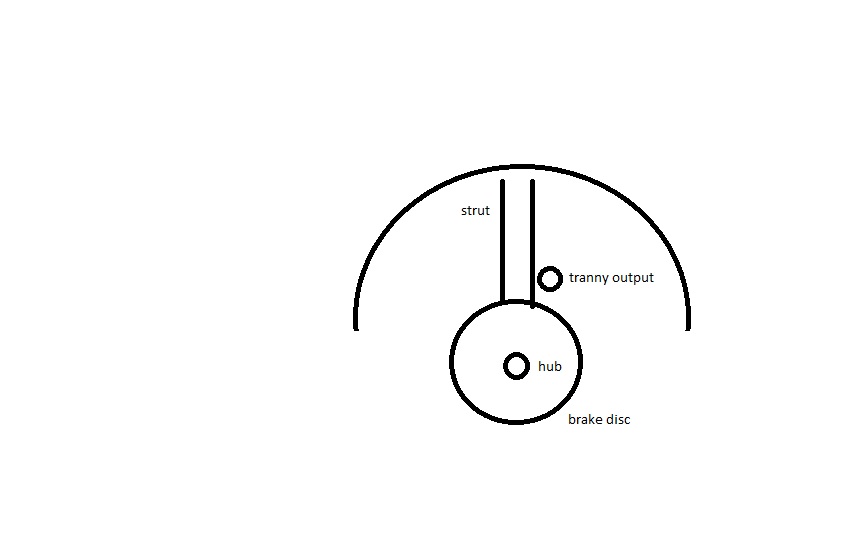

    Looking from the side of the car into the inner fender with the wheel off, where the axle comes out of the transmission is not directly in line with the wheel hub. It is the same situation on both sides. Where the axle comes out of the transmission looks at be at least 1/2" or more offset towards the front of the car. I believe the transmission output should be in line with your wheel hub.
    This is hard to explain, so I drew a quick picture. It is from the passenger side view, with the axle removed.

    Now here are my questions. Keep in mind that my car is an L body with the newer 94+ 3x00 mount setup.
    1. We all know that in the older cars (92-93), there was a 1" difference in upper mount orientation in an auto vs manual car, remedied by two different "T" pieces. However, with the 94+ mount setup, how can we know for sure that it is exactly 1" still for the upper mount relocation in an auto vs manual car? Since there was never a 94+ 3x00 manual car, I believe this to be an assumption made by someone.
    2. Is it okay for the axle output to be horizontally offset from the axle hub like my car is, as long as both sides are the same? In other words, as long as the drivetrain isn't twisted, is it hard on the axles? Has anyone else noticed this on their cars with the same setup as me? If you think about it, the transmission output will be offset relative to the hub in a vertical sense, depending on the ride height of the car. Or is there a tolerance for this?

    Do you have the 3100 and 4t60-e from the 94 still? Bolt them up, measure how far the axle comes off of a reference point of the block. Then measure on the 3500 to the axle output of the 5spd. That will tell you how much we need to move the drive train back..

        Think about this, what if everything moved 1" back (trans side welded up correct, upper engine mount T-bone 1" back), but they ALSO tilted the engine differently. Maybe rather than moving everything back 1.5" total, which might get things too close to the fire wall, they had it 1" back, with a tilt pulling the bottom of the engine/trans back to align the axles .5" more, and the top of the motor forward.
        What do you think? Maybe we are thinking only on X-Y and need to think about rotational alignment too... Cause as it sits with yours (and probably mine) when you get on it, the axles are going to move even farther forward if the mounts have any give...

          Yeah, I hear you on the rotation thing. The thing is though, the transmission side mounts will only allow so much rotation. My mounts are totally redone (not just filled) with shore 94a poly, which is basically as hard as a rock. There is no give, and if I force anything to move, it will only bend my mount brackets.

                I checked the parts car today - 93 2.2/5spd
                Same shit. The transmission output is offset towards the front of the car, about the same as my 3500/5spd car.
                So that means its like that from the factory.

                  I'm not surprised by this and it shows the reason why people were breaking axles before so easily even with a stock 3400... Just think, add one MORE inch to that miss alignment and then the situation just gets worse.
                  As you said it was probably done to clear the firewall as far as the alternator position goes for the V6's... Now on the 4 cylinders, who knows, maybe thats a downfall of mass production, all models suffer.
                  That was a nice drawing... Next time you should put a directional arrow for the front of the vehicle... LOL

                    With the Torque, would it not rotate back into alignment? (atleast in design)
                    If making Solid, or near solid mounts, you may want to take that into consideration and build in a little rotation.
                      With stock (sloppy) mounts, if they were built to line up, under heavy torque the engine may rotate that much to the opposite causing broken axles?
                      One you stray away from stock there is a lot more to consider. Not just replace with stiffer stronger parts I guess.

                        This is EXACTLY what I was originally thinking. But since my engine does not move at all, this is not the case for me.

                          So the stock position for the axles is .5" IN FRONT of the hubs?
                          Jon & Rodney & Planethax:
                          Ok when you get on it then, it is only going to move MORE in FRONT of the hubs.. Not back into the center... And the top of the engine is going to move MORE into the fire wall causing alt/blower fan interference.
                          Rodney, you may want to forget about the stock alignment and go for more of a centered alignment like the 4t60-e setup just to take stress off the axles at your power level. Even though your "solid" setup won't move much, it still isn't centered as is... And yeah 94 poly might as well be solid...
