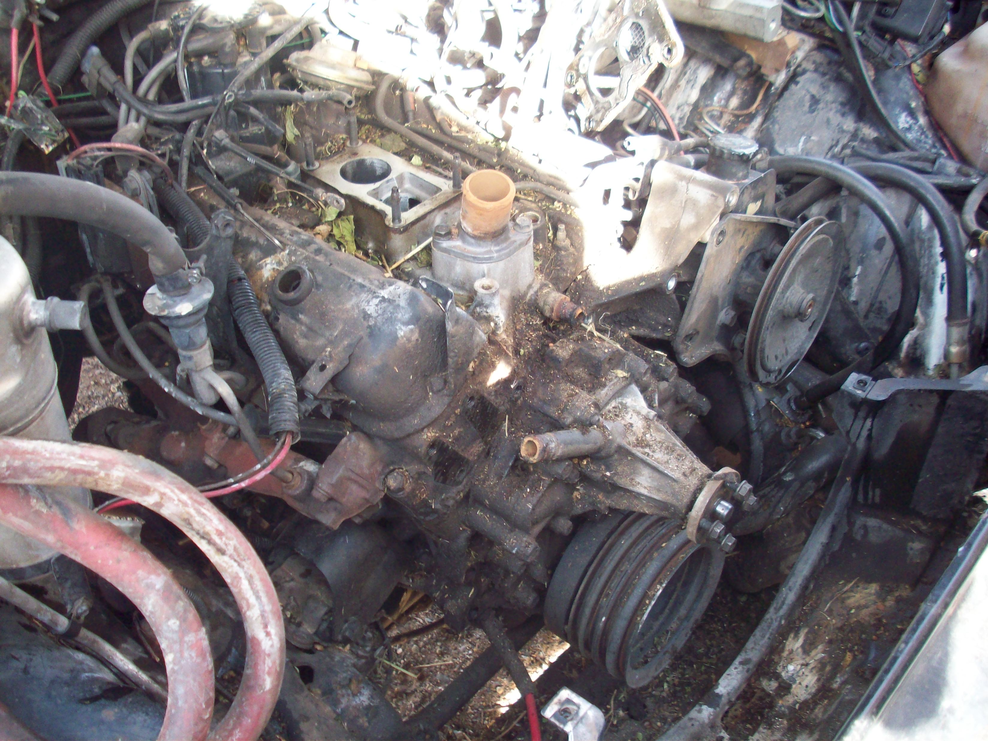

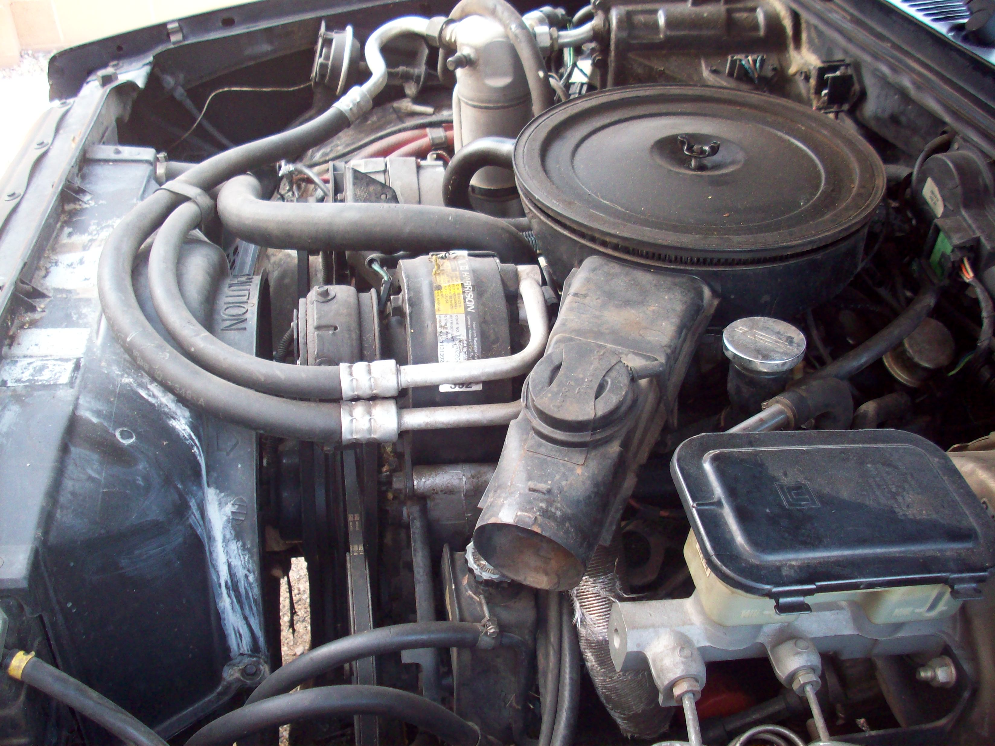

                        I got started tearing down my motor for the engine pull. Here are some pictures.
ID:	376444Click image for larger version
