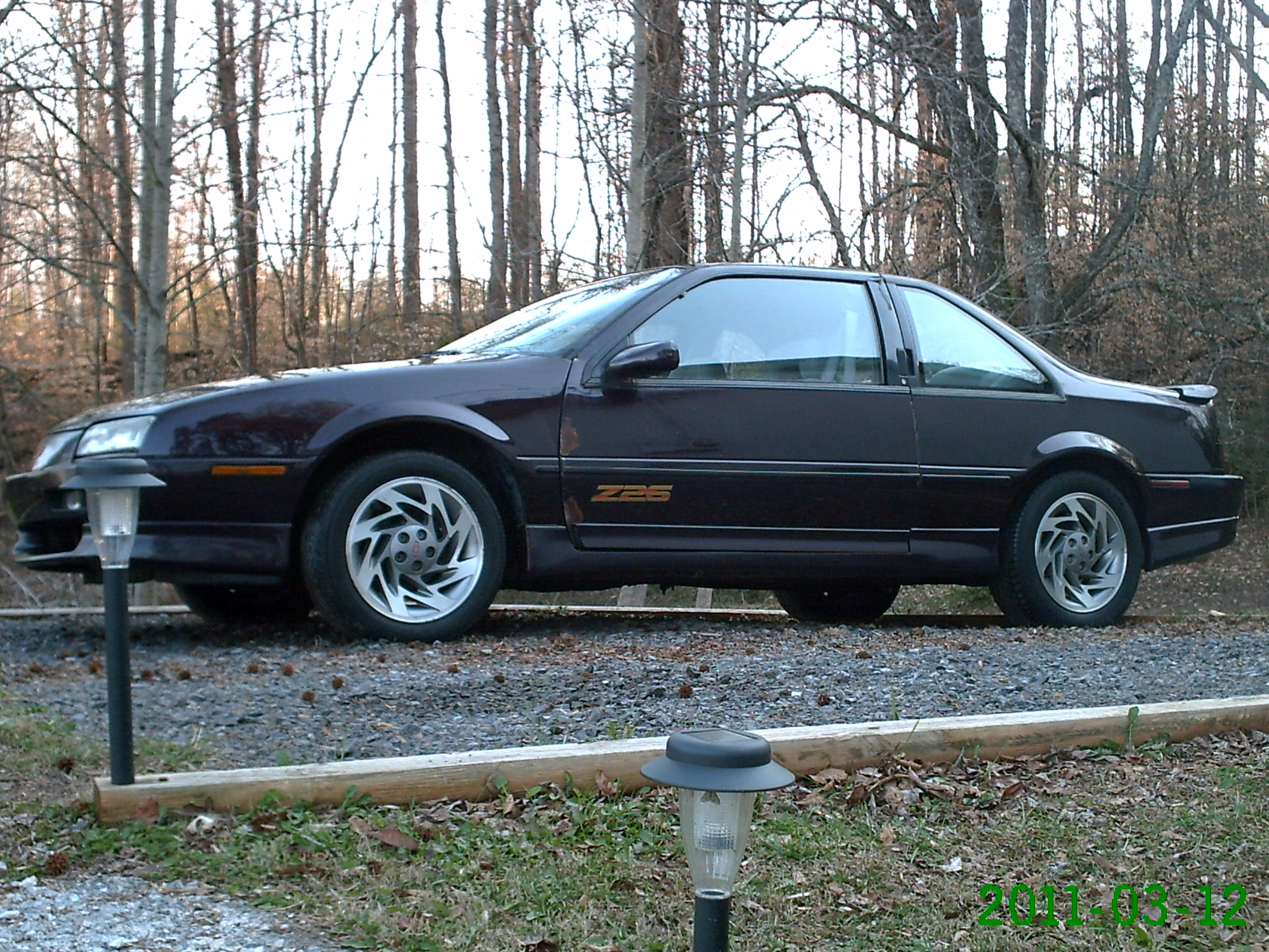

          It runs super,only problems I have are needs a oil pressure sending unit,mine broke and I J.B welded it but I guess it is internal.
          coolant temp sensor,reads way past H all the time,I tied it into a threaded drain plug in the rear of the block,but guess the sensor itself is bad,had problems with it before I changed engines.
          other then those 2 things,I am happy, will never change another FWD engine in this lifetime or the next.there is just no room,for my hands let alone tools,have airtools,they are useless on this car.
          Glad to have my Z26 back after it sat for 7 years,picked it up for 600.00.
