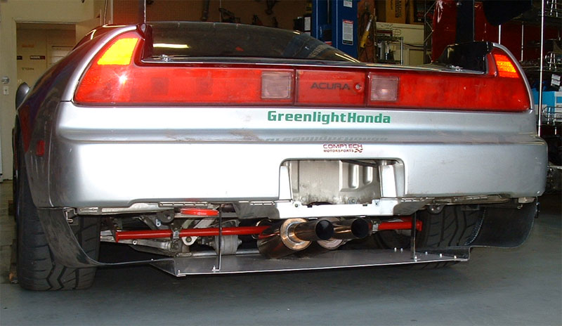

                    The tank sits level to the rear differential. I did this to give me a good place to mount the rear diffuser later. Something like this...

                      LOL still looks a bit low without the engine. Oh man there is a baby....don't know what it is about them, but I love the NSX. Must be the looks, sure is not the HP, but who really needs 800hp anyway.
                      I'll sure be watching on the diffuser. Can't wait to see how it's set up.
