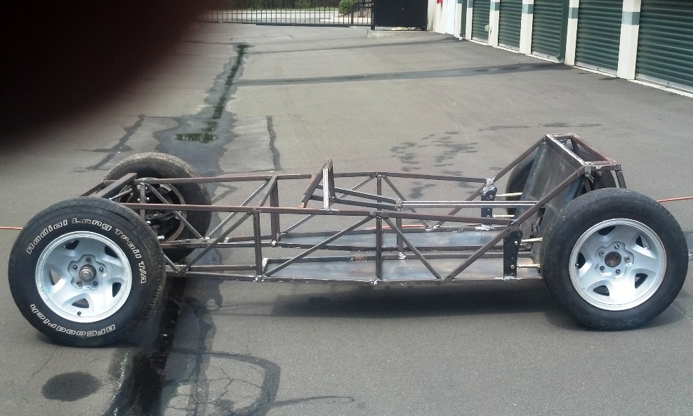

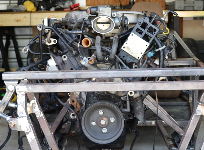

          Well, finally... I have the frame built to the point where it is a roller. I used a scrap 3.4 block and a t5 to do the mockup work, so I was a little nervous that a more fully dressed engine would actually fit into the thing (I moved it to the passenger's side as much as I could). Here are some pics:

          I've got to fab up some alternator mount that goes on the lower pass side of the motor, 'cause the stock position is where I want the hood to be. I think I might use a Fiero mount, and from there, figure out if the water pump will turn the right way.
          Also in my stack of parts:
          - OBD1 wiring and 1227727 ECU from a Celebrity
          - Top end from a 2005 GM 3500 out of a Malibu (newly rebuilt heads, intake, water pump housing, etc).
          - OBD1.5 ECU out of the Camaro (16184737). I have a vendor who says he will reflash it for $200 so I can get the car running (turn off VAT/VSS, etc). The attraction there is that I could simply get the thing running with the stock harness, allowing me to complete the car.
