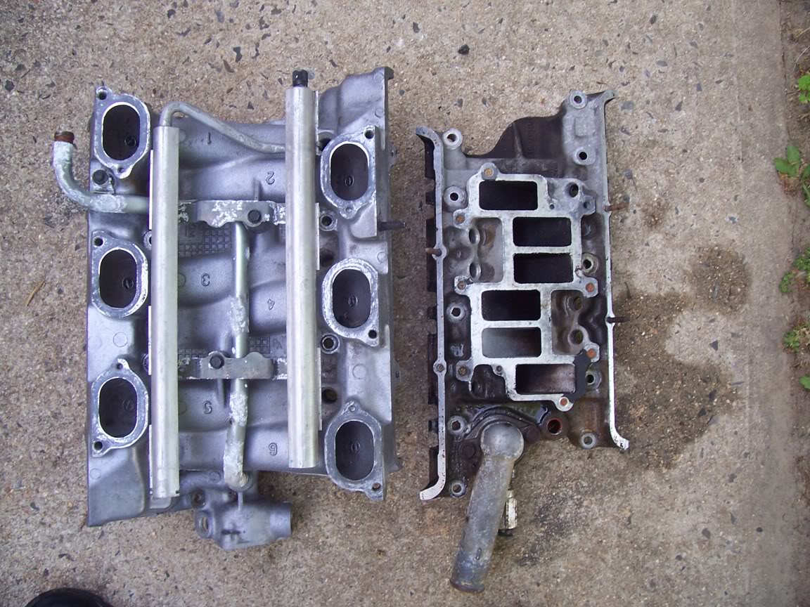

    Also, why is it exactly that a carb manifold form a Gen1 can't be used on 3x00 heads?
    I know it can't be used, but, why specifically?

    The ports on a carb manifold won't line up at all with 3x00 heads if you look at the two manifolds the difference will be obvious.
