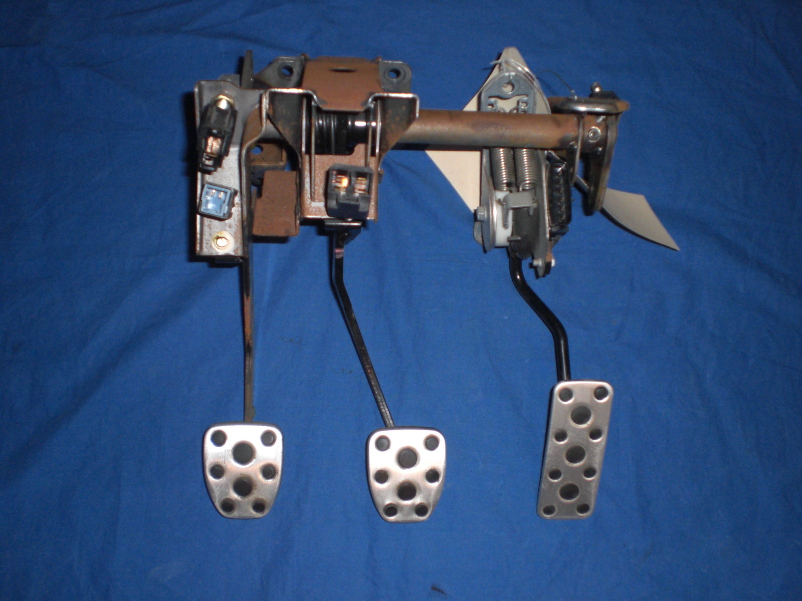

      Browsing ebay looking at pictures, looks like something like this might do. Set up for electronic throttle control, perhaps an earlier year would be better. Subarus are one of the vehicles more commonly equipped with manual transmissions, and they are plentiful around here.
      http://www.ebay.com/itm/04-06-Subaru...853b03&vxp=mtr

          I did an eBay "offer" on a WRX pedal assembly, thankfully the seller didn't respond and I didn't win it. I was getting ahead of myself again. I noticed the Subaru box moves the clutch MC to the right side of the assembly - likely where it will interfere with my RWD V6. I need to get the engine in the bay so that I can figure out these clearance issues before I go ordering parts...
