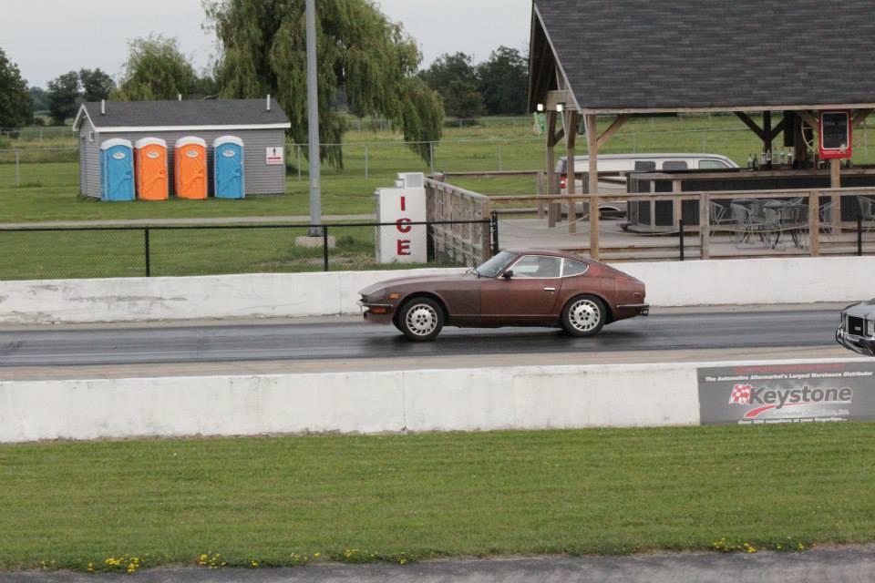

    Currently I'm running 10 PSIG, since that's the lowest I can run. My wastegate actuator is a 10 PSIG actuator. I plan to really dial up the boost, once I improve my fuel system and gears. I think better matched gears alone will make a noticeable improvement.
    A picture from last night:

    Nice times! How much boost did it take to get you in the 12's?

    Also went to the track tonight...
    Best pass was a 12.71 @ 115. 60' was 2.0 IIRC (slips are still in the car, will get them out tomorrow). I had two other passes in the 12's, first pass was a 12.97, and a 12.89 after the 12.71. Then the track went away and ran a 13.5, at which point I called it a night, since I have too much gear in the car. I actually shifted it to 5th on a couple of the passes. lol I'm thinking of going to 3.73's once I get the new rear end built. I kinda wish I kept the 3.54's I had that would fit in my current diff, since they might have been a better gear than my current 3.90's. My run is over about the 1200' mark, after that, the car noses over, since there's no cam left. I think after gears, next will be cam. Somewhere in there I have to think about injectors, and I plan to upgrade my fuel system as well, since I think it's about getting maxed out now.
