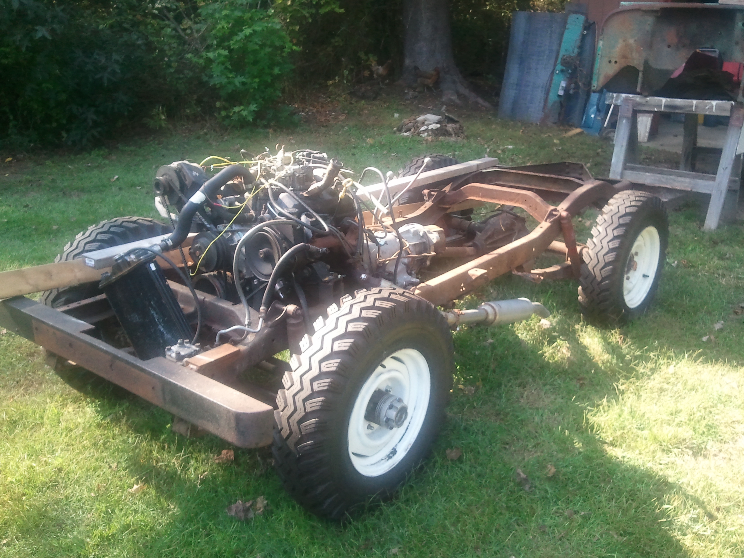

    Okay, need a little help here. This is my first post and if I am in the wrong area for this question someone please redirect me. I have transplanted a 1986 2.8 and 904 trans from a Jeep Cherokee into a 1960 Willys CJ5. I left the transfer case in the stock location for drive shaft purposes. I need to know the shortest water pump accessory belt set up because I am out of room for a radiator. My engine came with the long snout WP. It looks like the one from a Camaro 2.8 is shorter. What about FWD? They look very flat. What do you guys think how can I get some more room?

    Here is a picture (not good) and I will get some more.Click image for larger version

      I think you'll be in for some work whatever way you go.
      The shorter F-body water pump is only available in a reverse rotation design, as far as I know, and requires a serpentine belt system, which means changing everything on the front of the engine.
      The FWD set-up may or may not work, the water passage passes above the timing chain area and may interfere with the intake manifold. The FWD (gen2 and 3) are the shortest accessory drive available, but may be the most difficult to make work in a longitudinal layout, due to actual placement of the water pump, which is also a reverse rotation pump.
      Is it possible to move the drivetrain back? I would do that before trying to make a possible red herring of a belt drive system work. making new driveshafts is at many times easier to make or get made than modifying other systems.

        Yeah i thought about the drive shafts, but the rear shaft is only 13inches now and I put 3 inch lift springs on it. I don't think any shorter shaft would be safe? I found this thread and about half way down was a picture of what I'm thinking. http://www.mgexp.com/phorum/read.php?40,1951241

            All V6 Fieros have a clockwise rotation pump with a short snout. They use a 5-rib pulley and their belt setup uses a v-belt for A/C.
            Fieros are common enough that it shouldn't be difficult to get the pulley.

              Agreed a Fiero accessory drive should work out well. It is as short as a Camaro setup and uses a forward rotation pump that will bolt to the old style cover. It wont support A/C and Power steering though. But the serp belt setup is way more reliable than a V-Belt setup.

                    Raven, good info on the oil pan and timing cover. Geoffinbc I like that set up, but I am running power steering. Caffeine is that a standard setup you are showing or a custom one built from a fiero stuff?

                        All other things aside lol you should be able to simply unbolt your water pump and bolt on a Fiero water pump. Leave everything else the same.
                        You can either try to find a 6-rib pulley or do what we did and just run a smooth 87+ F-body/3x00 pulley. Some people say the belt might wear faster with the ribs contacting a smooth pulley but we never experienced this.
