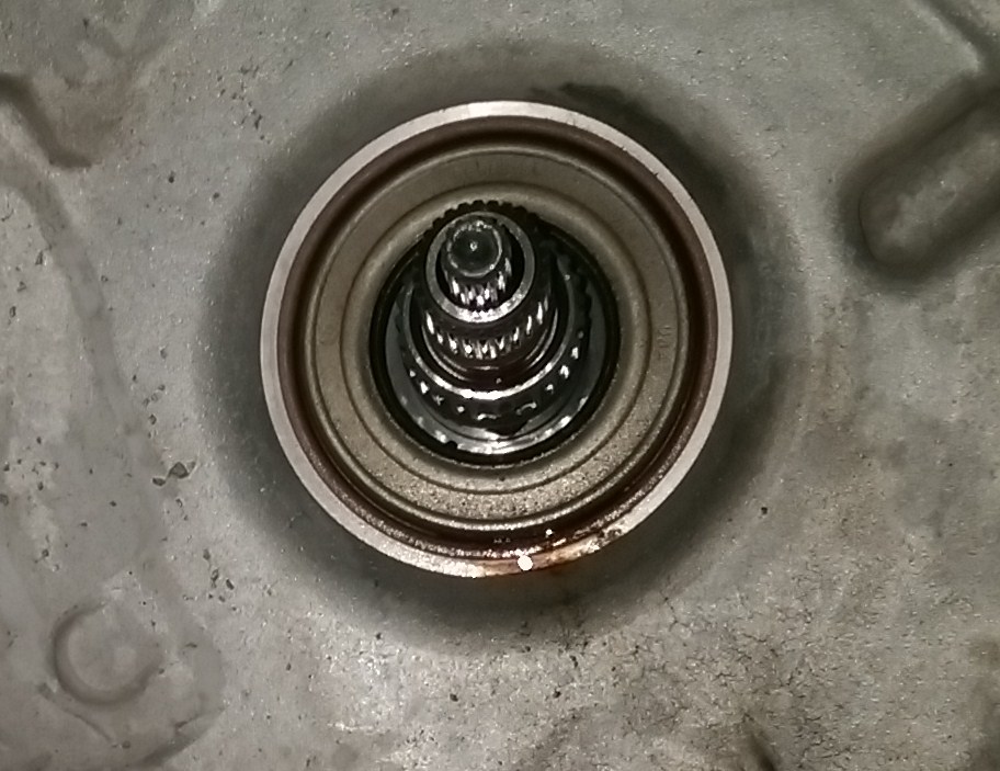

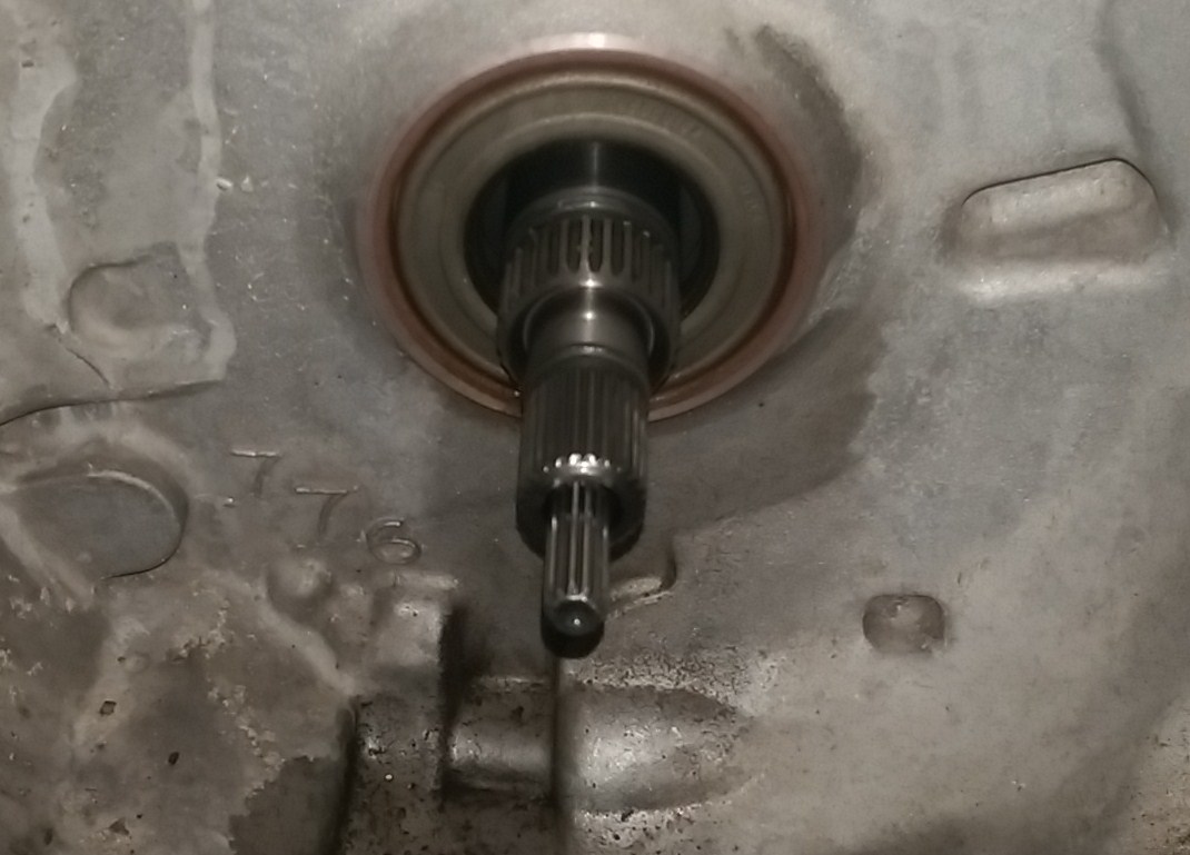

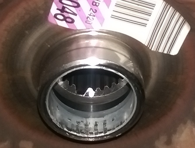

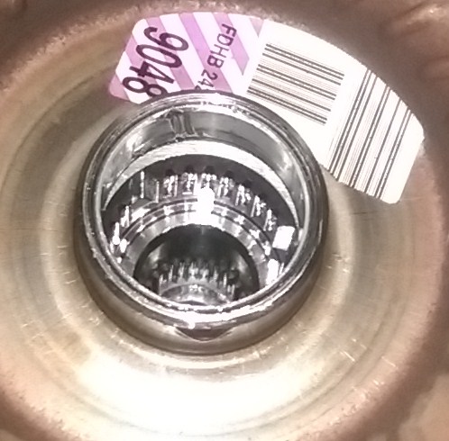

      Attached photos... I actually had taken a few last month but decided not to post them after looking at them again last night. Not real clear photos. Hope these are better. Also included photos of the splines.
      I did notice the larger upper intake ports on the Chevy engine-- but was very happy when I realized there was no difference when it came down to the mating surfaces on the heads of the Chevy and LIM of the Buick. So I figured this wouldn't present a challenge... Although I still have a small concern whether there's anything electronic to worry about. (For example... is there a modular component expecting the improved airflow and will not getting it cause the engine to run lean?)
      Believe me... I was fairly wigged out about the messed up holes in the block. Several days of research eventually convinced me of the viability of a Heli-coil solution. Heli-coil sells an extra long insert for factory spec TTY head bolts. (M11 X 1.5) Described this solution to an assistant mgr at a parts store and he ordered the required drill bit, the inserts, and the tap for me... I picked them up the next day. Drilled out the first hole and when I tried to tap it for the insert... I realized 2 things. He sold me the wrong tap and the installation tool didn't come up with the inserts. Long story short... I quickly found the entire kit somewhere else and it works like a charm. The messed up holes from the over-sized tap weren't too big for the Heli-coil repair... otherwise I would've ended up with Big-Sert.
      Granted... the only way to tell for sure about the Heli-coil repair is if I'm going to be able to torque to specs. Just don't want to reassemble until I'm confident I'll be able to use LIM gaskets and the head gaskets I've already torqued most of the way down once. Don't want to buy them again unless I have to... Click image for larger version

        I don't see anything on the converter that would be horrible. If there is any kind of burr on it, try to smooth it down.
        As far as a heli-coil on a head bolt. .. . let us know how that works out. Personally, I wouldn't be comfortable with it. But that doesn't mean it couldn't work.
