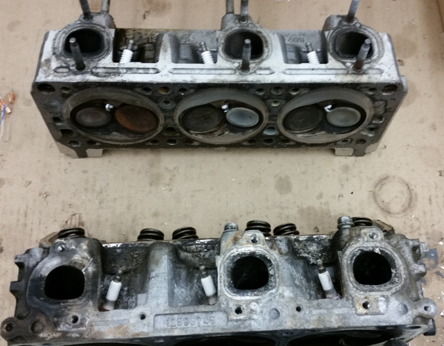

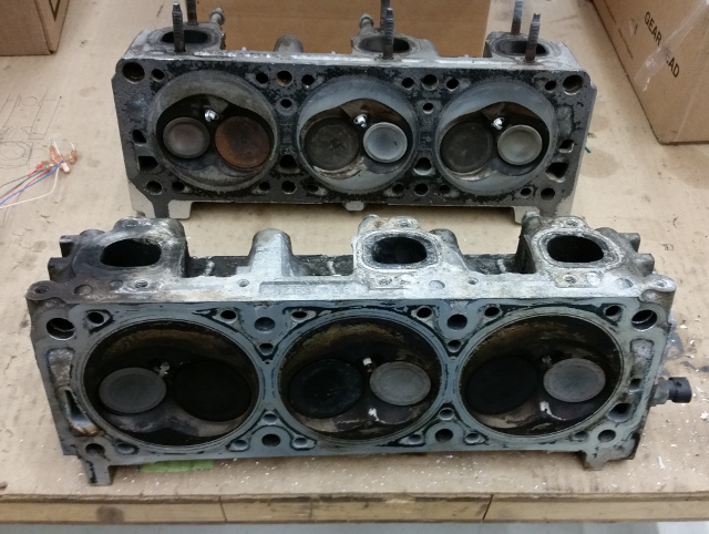

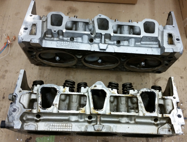

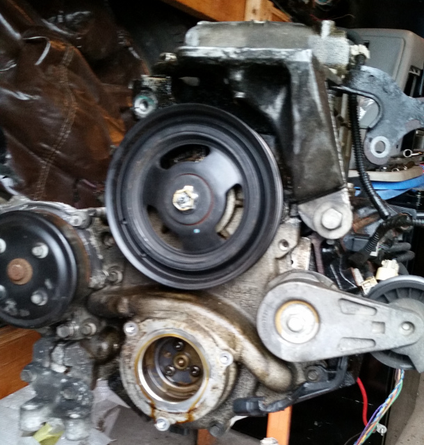

    So here are my first impressions of the LZ* series motor.
    My initial plan was not to dig into this motor too much. However, GM downgraded to exhaust manifold bolts instead of studs and I had 4 that were broken. So it was off with the heads so I could weld nuts on at work. It's nice to get MLS head gaskets for $20 each. I have to say that apart from the aforementioned bolts GM made some nice upgrades. The stock intake gaskets are metal even though coolant no longer passes through them. Compared to the LX9 the ports and valves look significantly bigger as seen in the pictures. Getting oil squirters for all cylinders was a nice bonus too. I didn't quite get the timing cover off to look at the phaser as I can't seem to find my 3 jaw puller.

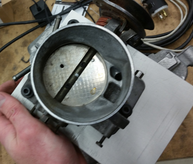

              The LZ4 intake diameter is 75mm so that makes the truck TB seem like a reasonable size- maybe. I'm probably half way through machining an adaptor- smallish chunks of time make custom pieces take forever.

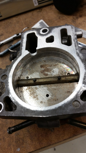

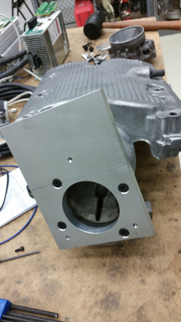

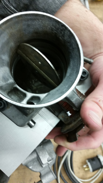

                        So the first step is done on the TB adapter. It all bolts together nicely. I'm waiting to trim it down in case I want to use the extra material as a mounting point. I probably would have forgotten to open up a passage for the IAC if I hadn't just read about it in Ericjon's thread. Hopefully that notch is enough. If not, it's easy to change later. And after getting it all done I discovered that I could have bought one at http://www.killerbv6.com/shop/all/tb...r-lz-lx-detail. It certainly looks a lot better than mine.

                        I also took apart the the cam phaser. It's an interesting piece. My plan to limit it's travel wouldn't have worked and I may abandon that approach altogether. I did some more reading while trying to find the thread where phaser travel was limited. Basically I didn't realize that the VVT cam is ground quite differently. As a result, operation of the phaser is important to making the most power not just the lowest emissions as I originally thought. So fully operational VVT has become a higher priority.
