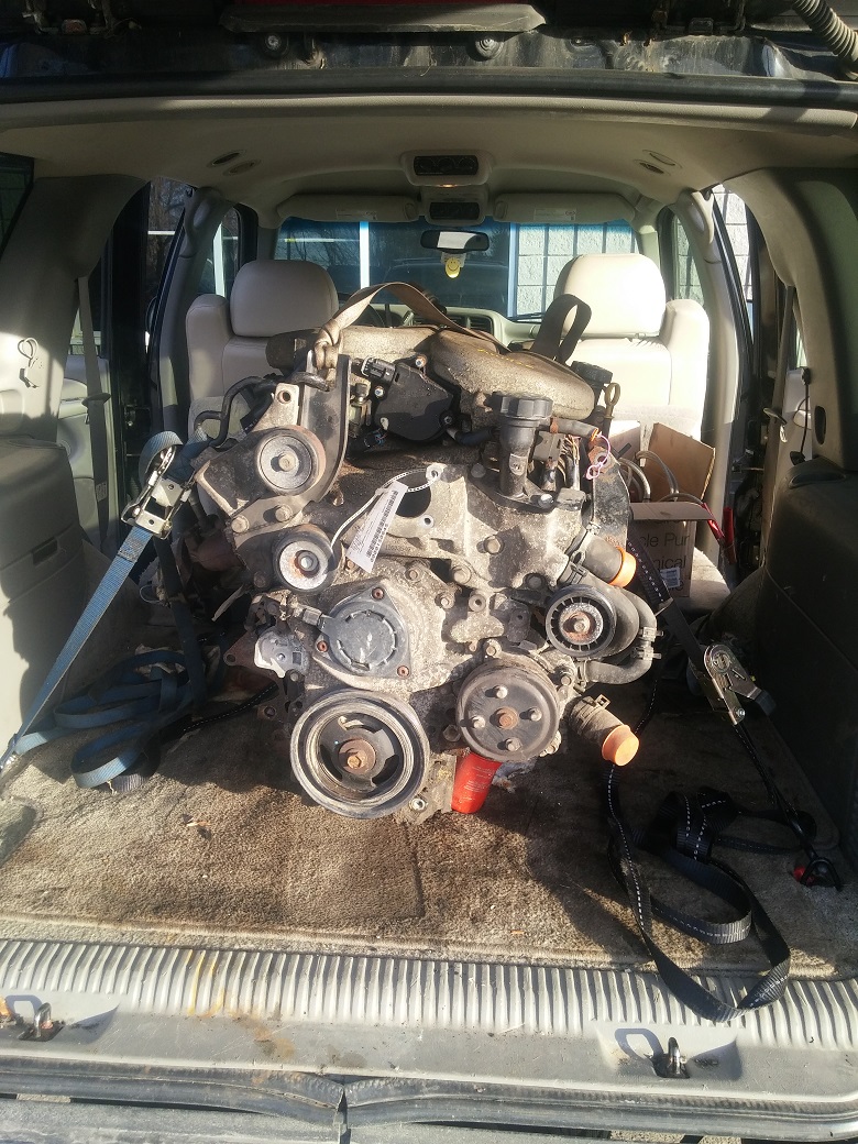

    I picked this up Tuesday (2016-02-23) for a great price. It's a "higher" mileage one at 166K (approx 106,000 miles), but I was already planning to rebuild it anyway. The Eagle rods that I bought for the LX9 rebuild will now be going in this. The LX9 will still be rebuilt, but that's for another project, and eventual thread.

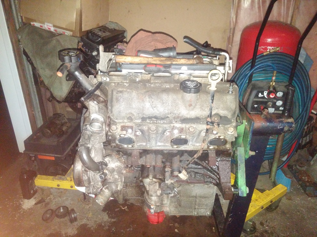

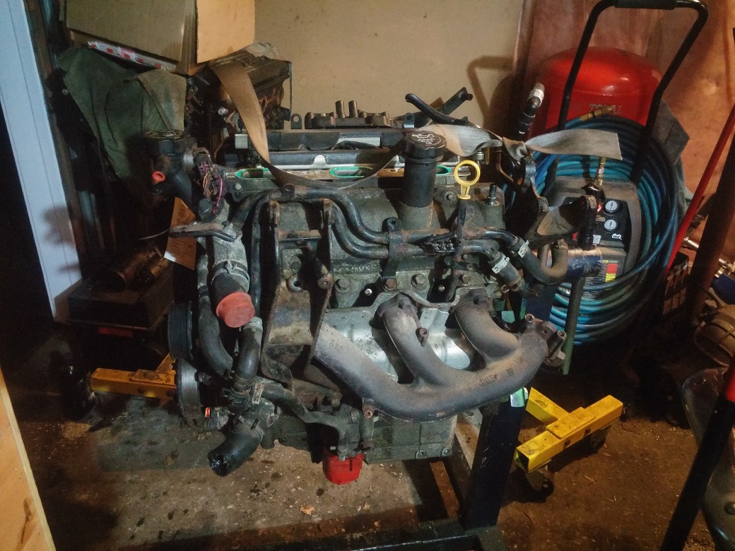

    I got the engine on the stand tonight and started taking off the stuff I won't need and studying the coolant system for modification.

    More pictures to come as I take it apart (I won't dwell on this aspect because there's a number of threads with LZ9 pictures already), and as I come up with solutions to the issues I am going to have.

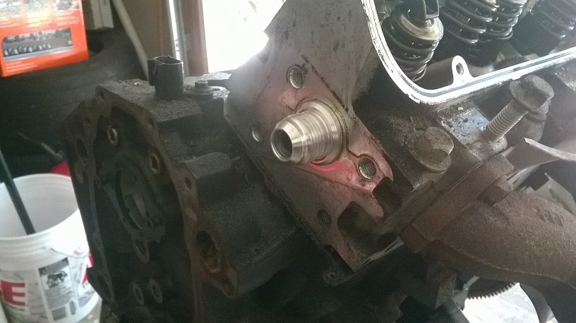

          excellent choice. I got these fittings and with a alt bracket so to speak from BCC. I haven't test fit the alternator though with the bracket yet but it should fit just like a lx9. I plan to use a fiero or camaro timing cover pending on which way I want the waterpump to spin.

            Yeah, I'm considering a similar solution for the coolant crossover. The BCC bracket mounts the alternator in a similar location that I had mine. The BCC bracket work work for me though, I'm using a Toyota alternator. I refuse to downgrade to a GM alternator again. lol
