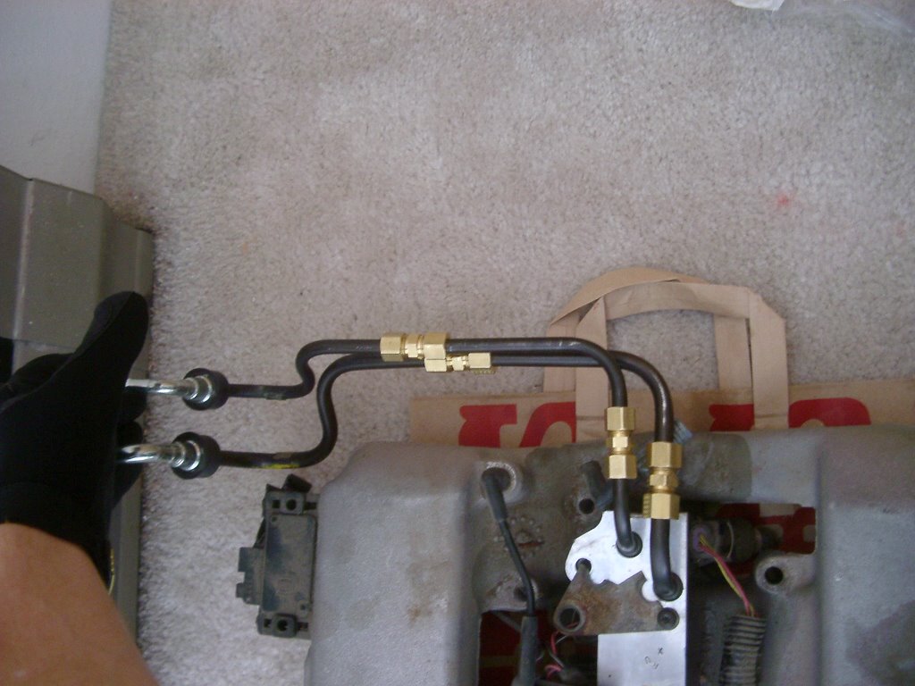

      I took the axe (dremmel and hacksaw) to my 3.4L fuel lines. Relocating to the left side facing the engine. Once I dig up some appropriate size sleeves, I'll solder this thing up! Unless there is some taboo on soldering fuel lines. I can weld them, it'd just be harder.

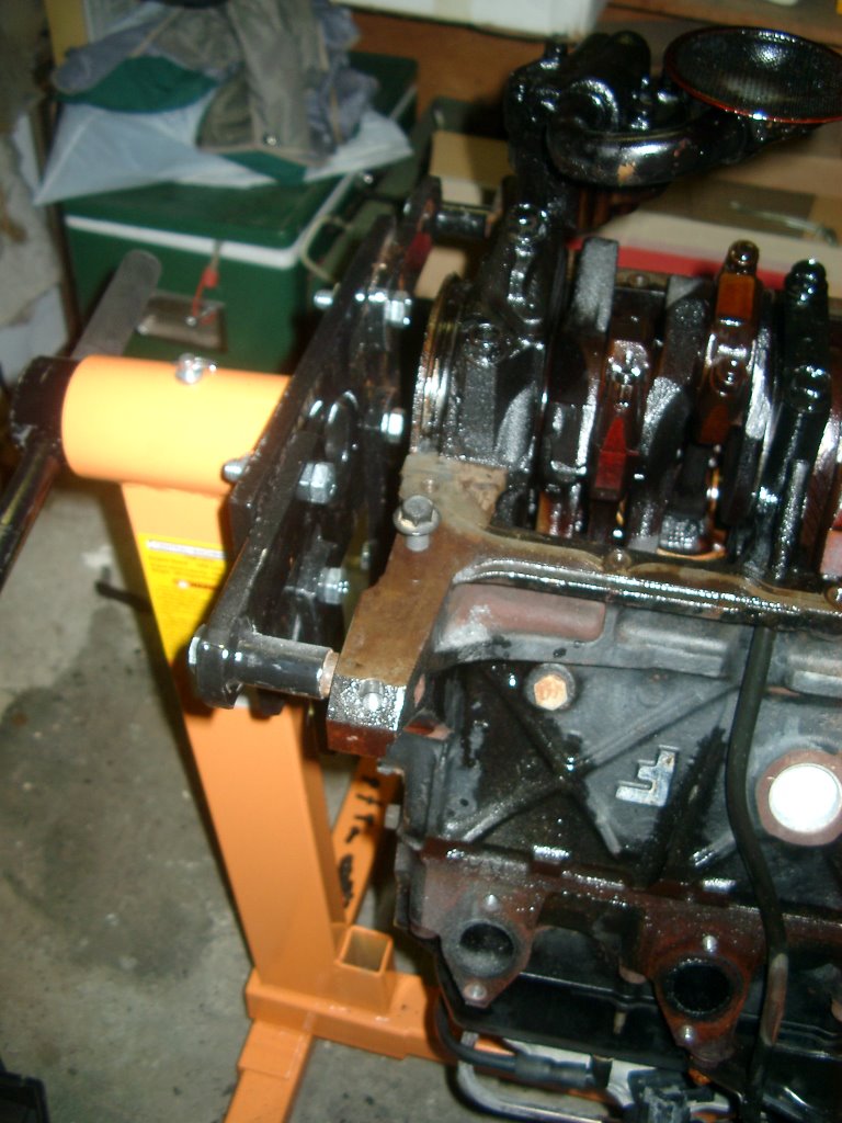

      Finally got the bolts to put my engine on the stand. Soon I'll be able to flip it over, pull the smashed firebird pan off, tap my starter holes, and install my oil pickup. Hurray.

            Uhg, I finally have my engine on the stand now. I got to looking over my exhaust manifolds. Some bastard broke a few bolts off. *sigh* New gaskets on the way. Now I need to get both manifolds off, ez-out the broken bolts, and dig up a new set. Grumble grumble...
            Spent some more quality time with the hacksaw; my fuel lines are all chopped to length now. Just need a little touching up with the dremmel, then I'll sweat those suckers back together and paint 'em up.
