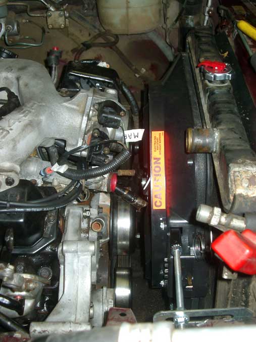

  • Canyonero
    replied
    Yes and no. I have A/C so there's a condenser on the other side. Aside from that, I haven't looked. I'll pull the radiator out again today, I just put a couple bolts in to test the fit.

  • CNCguy
    replied
    Hah, slight miscalculation. The Trooper engine bay is smaller than I thought. I see why people don't do the swap this way - the engine doesn't seem to fit...
    At a minimum, I need to relocate my battery and get a different electric fan. I'm thinking a dual 10" instead of a single 15". Less CFM, but still adequate.
    I'll make it work. Just you wait.

  • Canyonero
    replied
