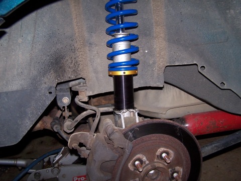

          guy, held motorsports makes gen1 kits, hence the pic. Trust me, save yourself the headache and buy one if you want a coilover kit.
          I have a full coilover kit, below i have a pic of the rear as well as the way my car sits with it installed.
          as far as the noise, about 30 miles after i first put it in, it would squeak. After about 3000 miles, it went away and never came back.
          p.s. the handling difference is insane!
                  My rear FFP coilovers did the same exact thing with the sound. It would squeak for about 10 months of driving then go away.
