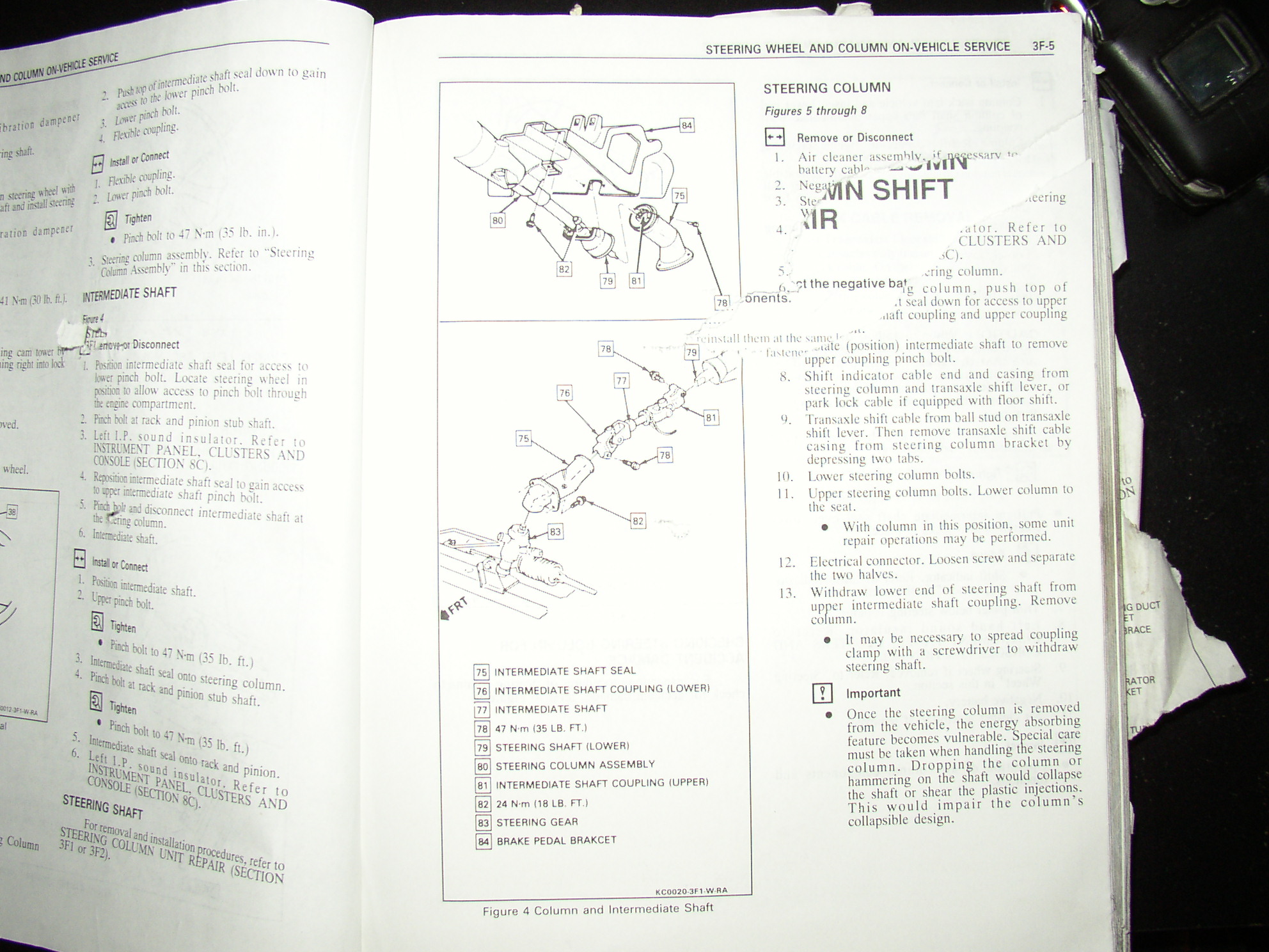

            He asked me for pics. I said I could do that since I was going to take the set out of the 91 that has the accumulator removed and toss it in the 92. With the gas prices, my truck sees the streets way more then my Lumina, especially since I have a hard time not driving the car like I stole it...
            EDIT: I don't see a shim in my book, but then again when we got our dog, guess what he decided to make a snack out of one day? That's right, my shop manual... And the lower part of the steering column is part of what he ate.. There is part of the pic left though:

              Thanks for the pic. I got around to it and shimmed it again. Seems to be holding up thusfar and no slop. I hope it stays that way!

                you sure you got both pinch bolts tightend to spec? I belive they are around 40ftlbs. Those losse will cause problems too.
                My intermediate shaft has a very slight amount of looseness..But overall the system seems relatively tight... No vibration other than normal.
