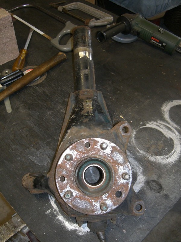

                      Very interesting. I had no idea there was a larger disc option on later w bodies. What years and models can I find this on??? I imagine the calipers and calper bracket is also different. And there are no bolt up problems??
                      Just so we're clear here is the part I'm looking at modifying. This is off the W-body site and not my picture...

                        Yeah, you need that whole assembly from a newer W-Body. Not sure what years, prob 96-97... Either on this site or wbody.com (more likely) there IS a write up on everything that is needed and how to do it. Basically you need everything in your pic plus calipers and rotors from the newer DONOR... I haven't done it,, but I've heard it helps alot....

                            my 1995 Monte Z34 has the larger factory disc brakes. its part of the newer F41 or FE3 package... IIRC. the caliper is the same, you need the newer Spindles and larger rotor, your hubs and your calipers are the same. if you look online for new rotors for a car it will show 2 different sizes, that should tell you what cars came with them.
