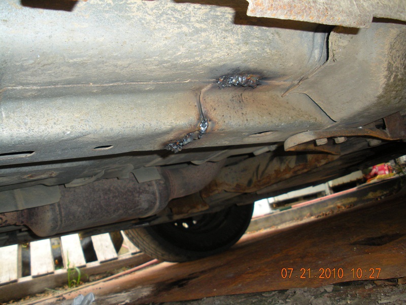

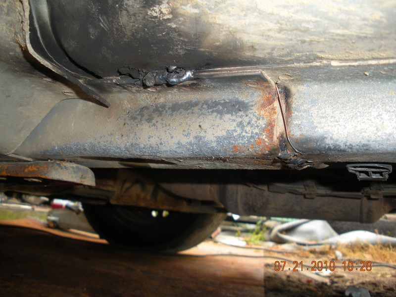

                          I ended up being very conservative because I wasn't having the best day with the welder, so I must warn that the welds look like crap. give me a bit of a break because its my first time welding overhead with a MIG. welding to the actual floorpan is the hardest part. I wish I had more time I would've ground the welds down at least. I already undercoated the underbody, but left the lower control arm area because I may weld that later (thicker metal=easier to weld). as for performance difference, it's slight at best. the real difference is peace of mind, which is kind of a driving aid. good experience, but bad results. sorry guys, I kinda fell short on this one.
                            i've seen(and done) worse.
                              Live life 3.7mi at a time
                              • 4555
                              Looks to me like you are moving the puddle too fast and have your wire speed too high. What type of welder are you using, amperage?
                              If you are using a Miller MIG, I would suggest putting the electrode in the #1 position (if it has a dial, use 25amps, or #1) and start with the wire on it's slowest setting, slowly bringing it up until you aren't burning the wire off the tip. Make a small circle about the size of a #2 pencil eraser, move 6" away and repeat, then go back and make them 3" apart, then 1.5" etc.
