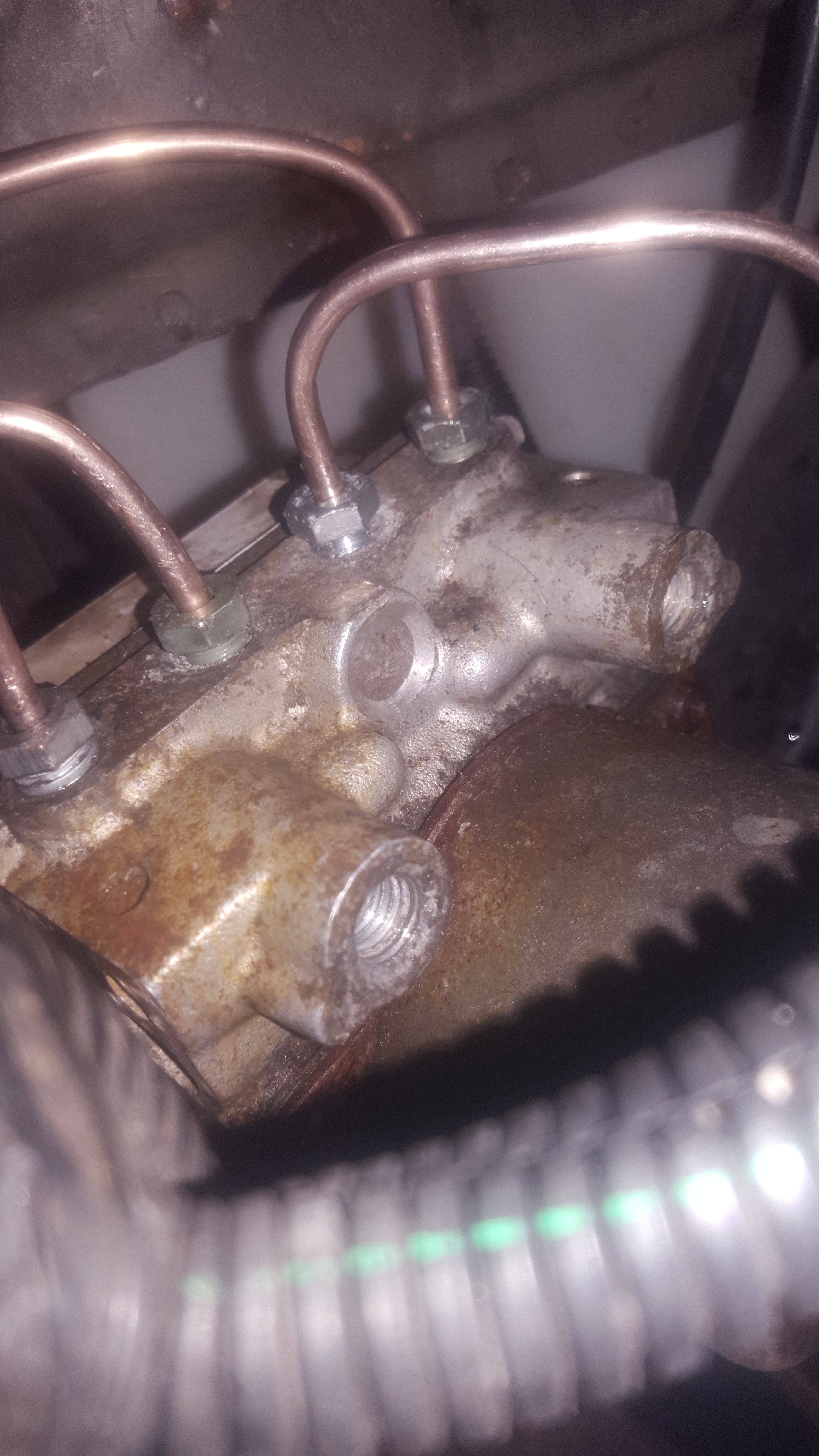

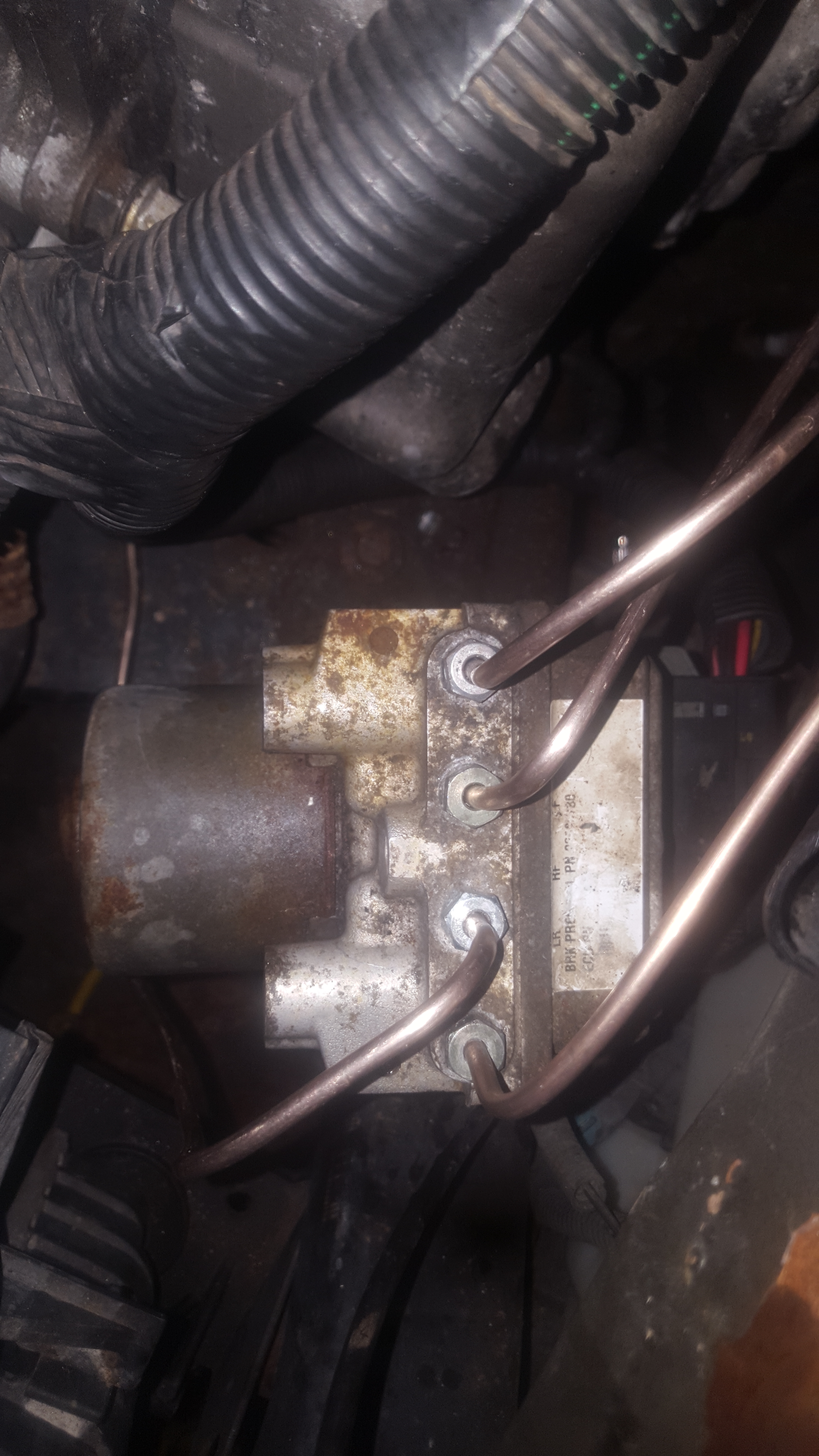

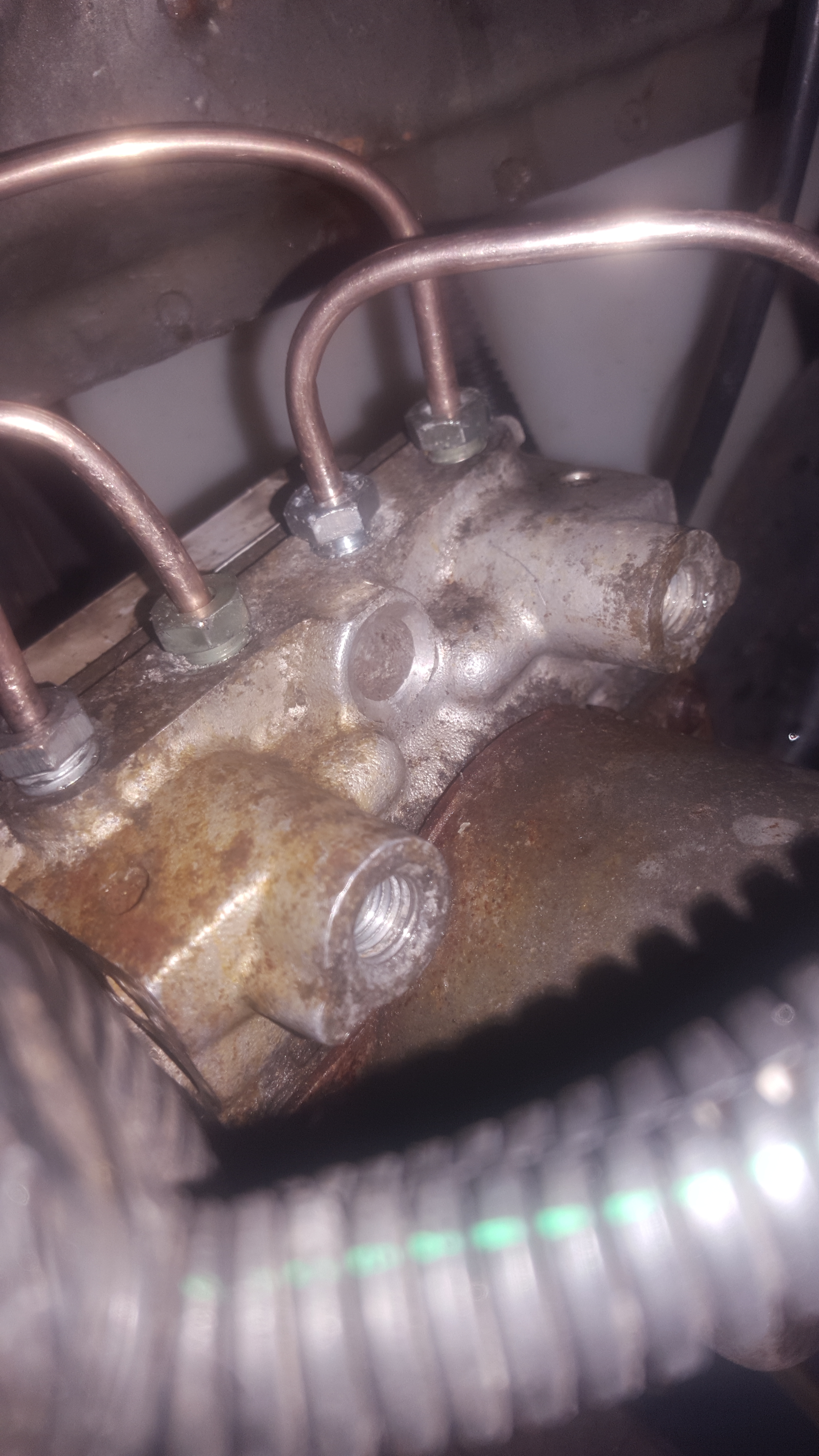

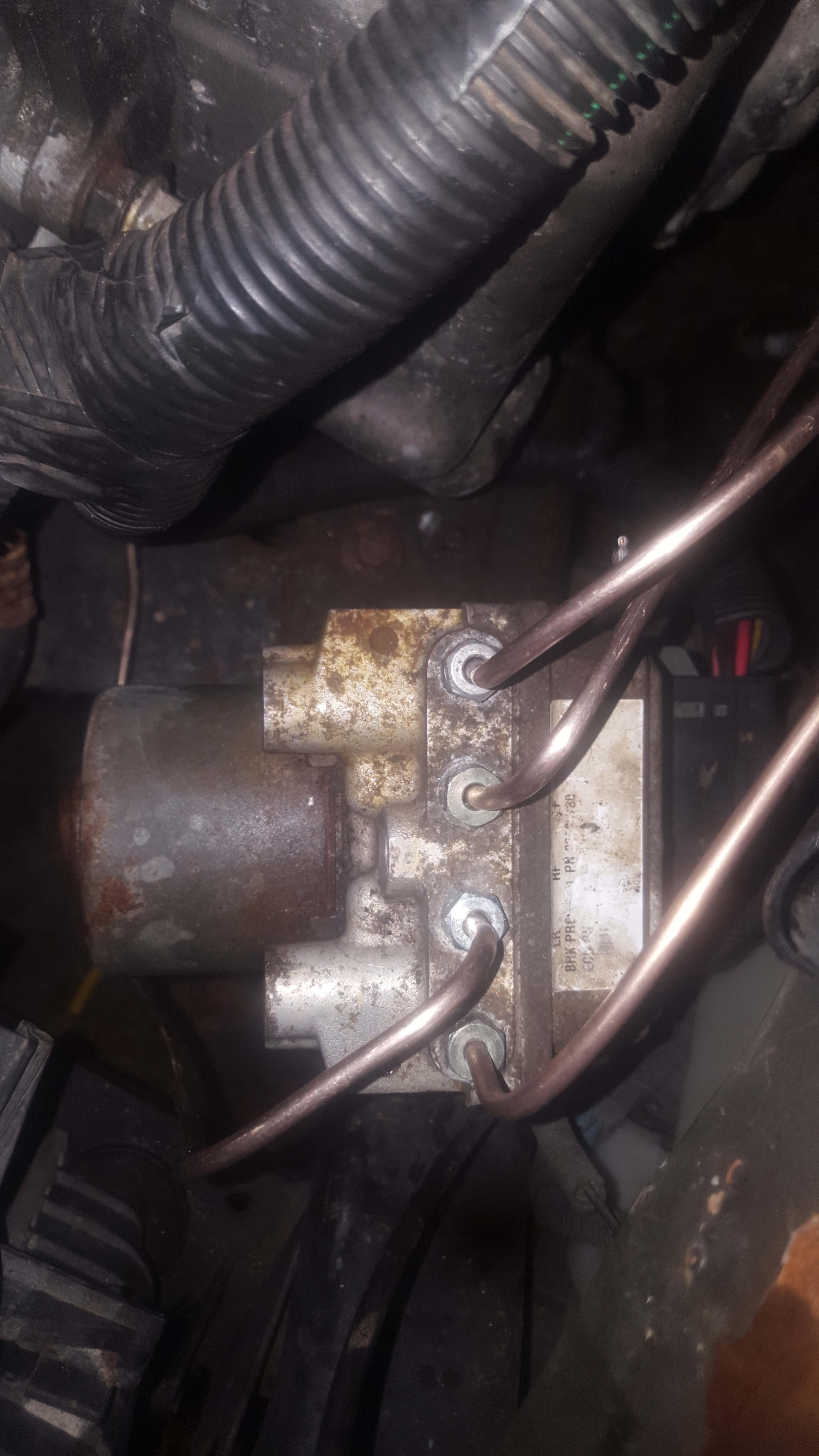

    Hello Everyone. So I decided to rebuild the old 03 Grand Am GT instead junking her, and had to replace all the brake lines, but I can't remember which line goes where, between the master cylinder and the ABS Control Module. The brake lines to the wheels all go to the top of the ABS controller, which is labeled, but the two lines that go to the master cylinder, connect to the side of the ABS Control Module, and there is nothing indicating which goes to the front, and which goes to the rear of the master cylinder. I meant to save the old lines, and just see where they originally fit, but they ended up out with the trash. Does anyone maybe know which of those two lines out the side of the ABS Control Module, goes where on the Master Cylinder? Thanks for reading!
    ABS Controller:

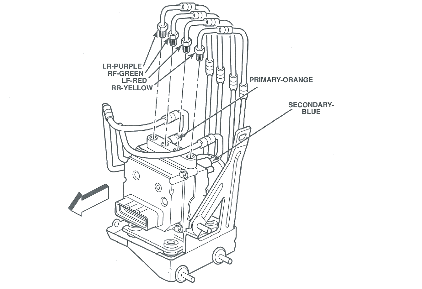

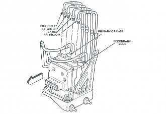

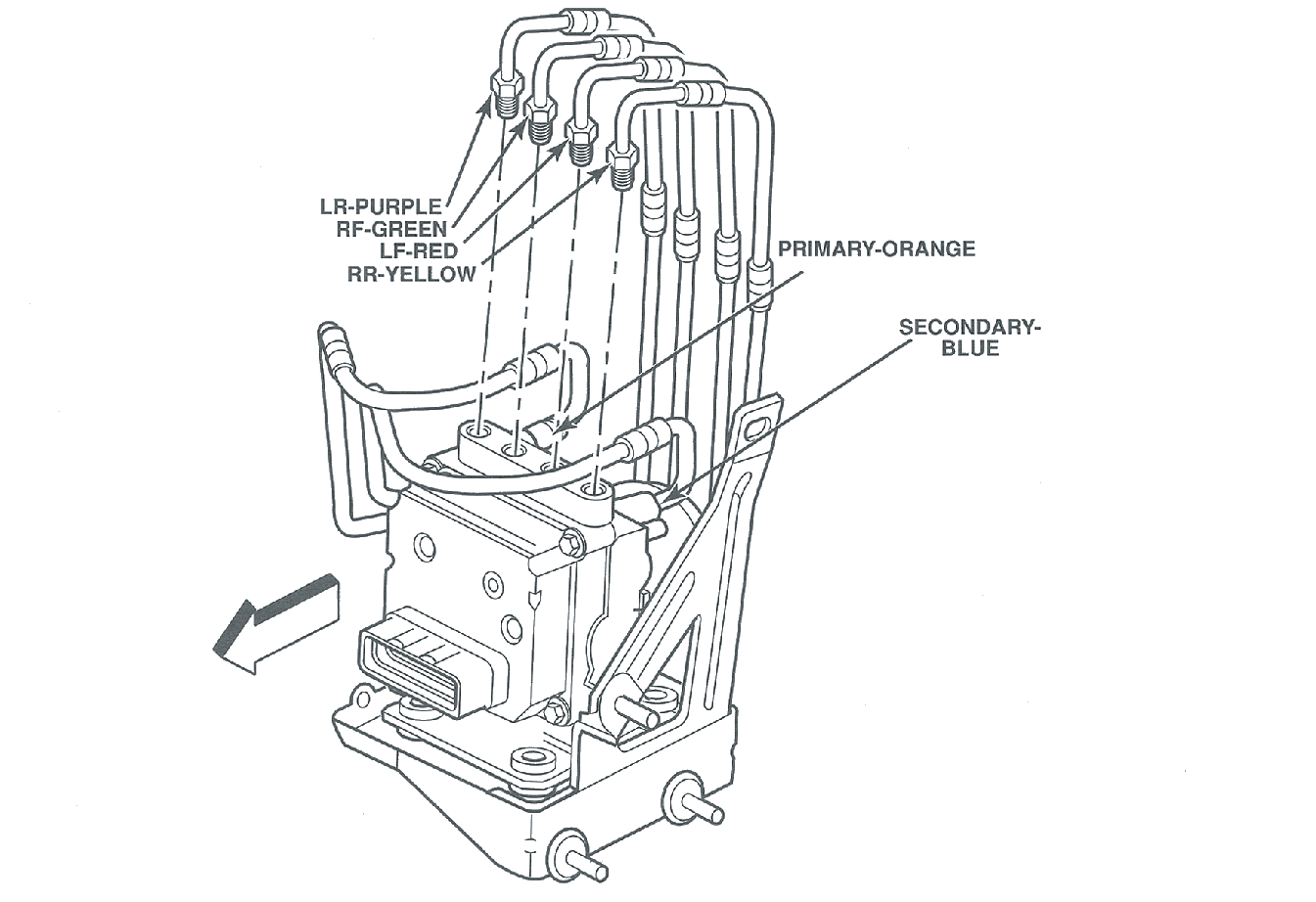

    I got it! Found it in here - SWB_a5_m10b_Final.pdf, along with lots of info on many other GM ABS Systems.
    Click image for larger version  Name:	DBC7.png Views:	2 Size:	283.9 KB ID:	426121
