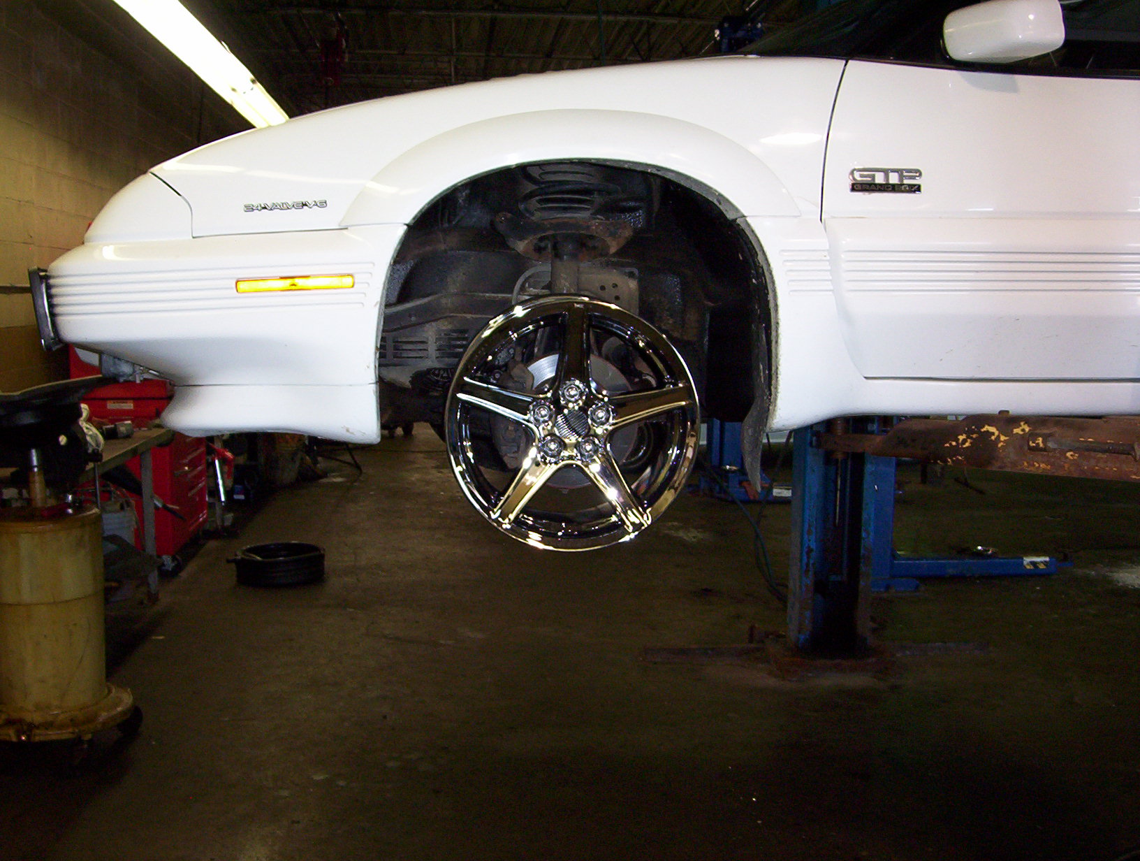

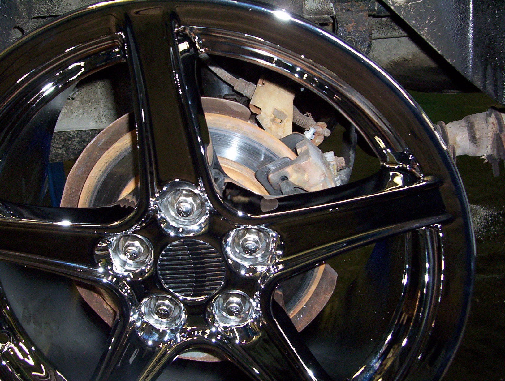

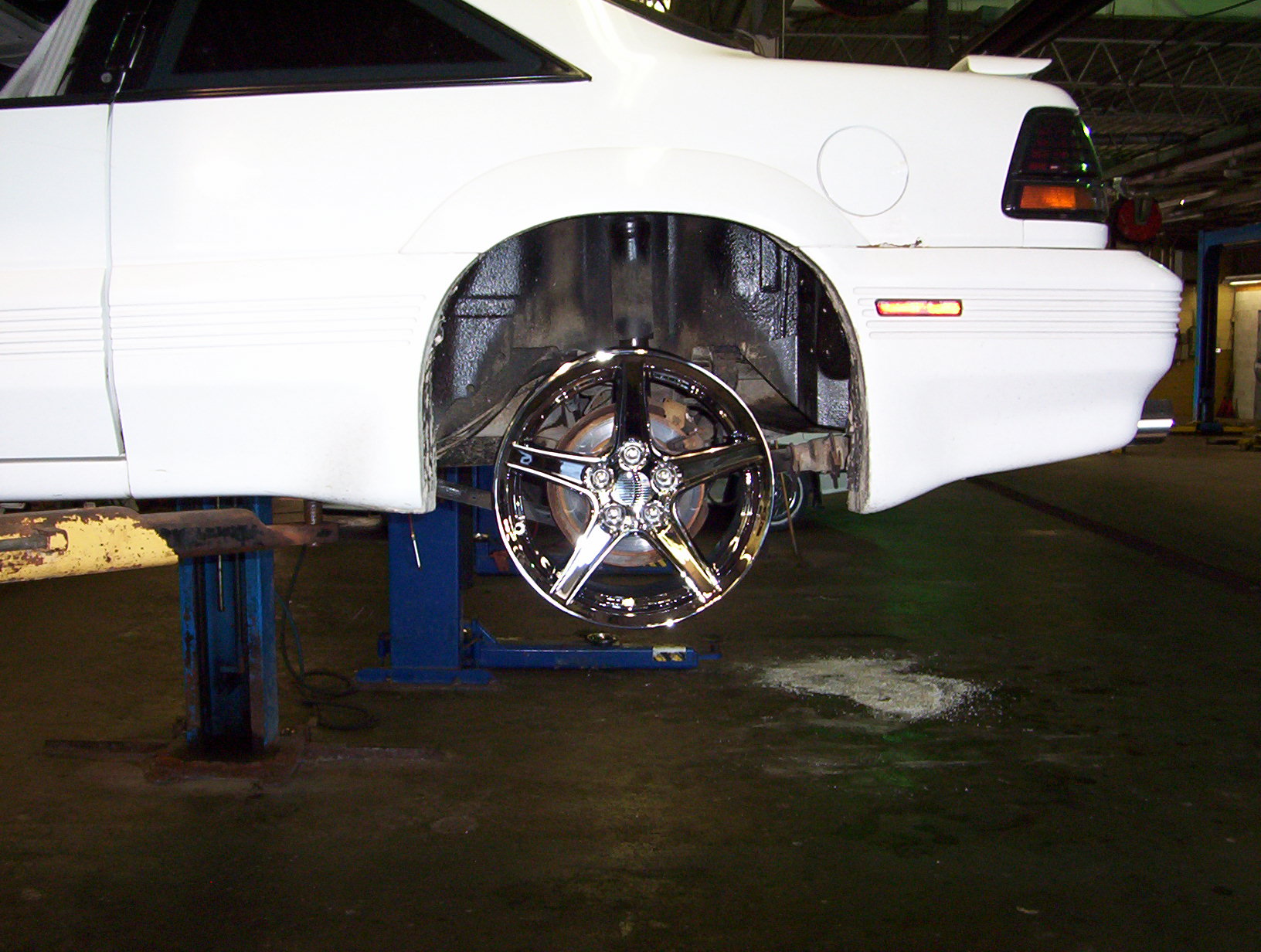

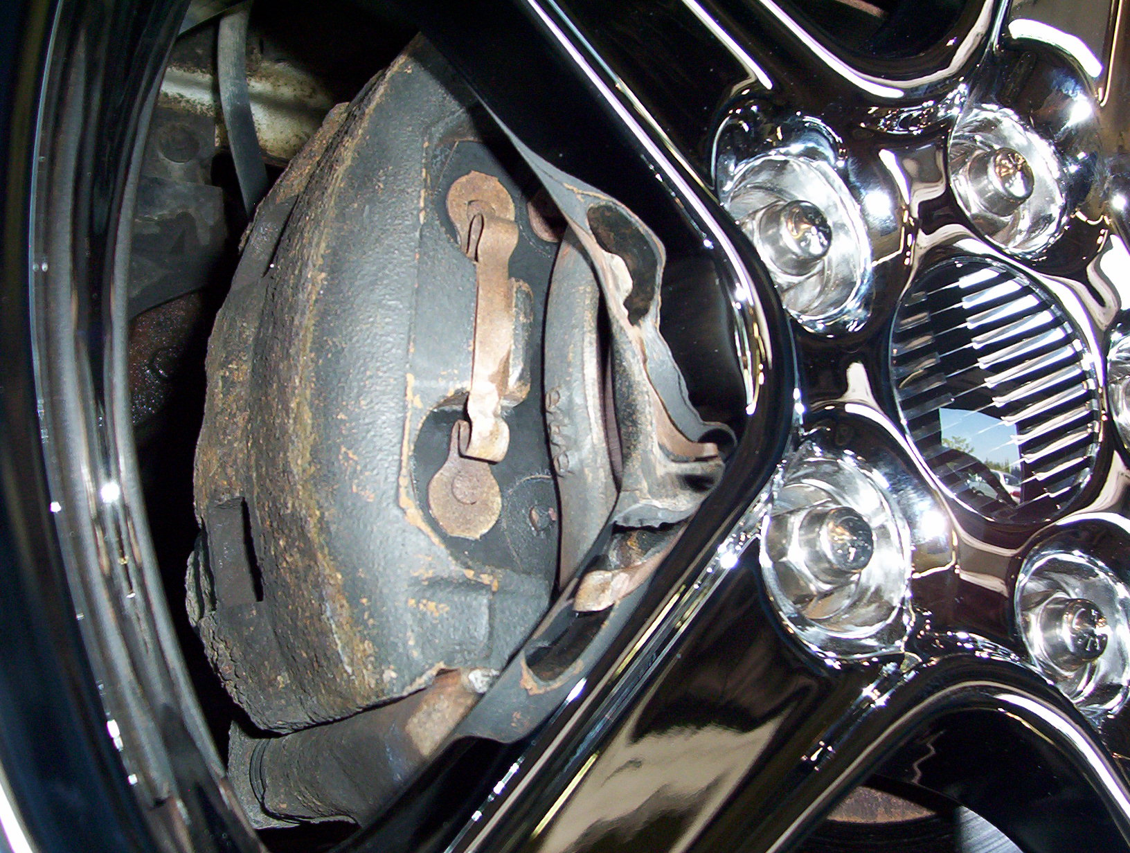

              heres some pics of the rims alone on the car no tires yet, cannot afford it. But the rims look good, there gonna go on my dark blue car so they will stand out nice.let me know what you think.
              Jake

                something in the 255/40 range? 245 is too narrow for a 9" rim. 275/40 is perfect but dunno about clearance.
                i'd buy one of the desired size tire and mount it, get it on the front with the car on the ground, and check clearances at full lock both ways.

                    • DEI37
                      • Jan 2004
                      • 516
                      I think you're gonna be off on clearance by quite a bit with a 275. I think you'll see that a 255 will be as wide as you can go. One way to test it is to take the tires you have now, turn the steering full lock both ways, and take measurements when it is at full lock. See how much clearance you have, and that will be a good ballpark at least.
