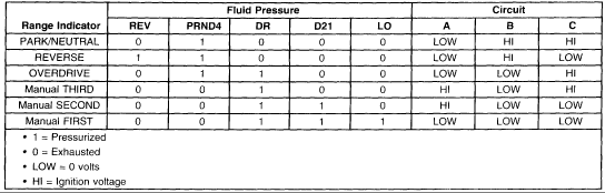

    here is what you were wanting to know, and this is why i wouldnt hack into the harness for anything trans related really. first part is press, second is temp. if you do want to do this though, maybe using the auto trans interceptor would be a good idea, since it plugs inline and can give you a place to tap in to, and still keep the press normal. but thats just a thought and i would recommend using the non electrical components for the values you want
    The automatic Transmission Fluid Pressure (TFP) manual valve position switch assembly is attached to the control valve body. This assembly contains six fluid pressure switches and the automatic transmission fluid temperature sensor.
    Five of the fluid pressure switches are normally-open. These are used to indicate the position of the manual valve. The PCM uses this information to control line pressure, TCC apply and release and shift solenoid operation.
    The release pressure switch is used as a diagnostic tool to confirm that the TCC is actually OFF when it has been commanded OFF by the PCM. This switch is normally-closed.
    Each fluid pressure switch produces either an open or a ground to the PCM depending on the presence of fluid pressure at the switches. The sequence of open and closed switches produces a combination of voltage readings. The PCM monitors these readings.
    The PCM measures TFP manual valve position switch signal voltage from each pin to ground and compares the voltage to a TFP manual valve position switch combination table stored in the PCM memory. If the PCM does not recognize the switch sequence diagnostic code will be set as a result. A diagnostic code may also set if the TFP manual valve position switch sequence indicates a gear range selection that conflicts with other sensory inputs to the PCM.
    Fluid Pressure and Circuit Combination
    see pic
    Valid combinations for circuits A, B, and C are shown in the table. LOW means that the switch is grounded with a resistance less than 50 ohms at 0 volts ; HI means that the switch is open with a resistance greater than 50 K ohms at 12 volts .
    Note that resistance should be measured with the engine running. When the transmission's pass through connector is disconnected from the vehicle harness while the engine is running, multiple diagnostic codes will set. Clear these codes when you are finished with this procedure.

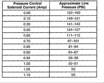

      actualy running a tanny interceptor now, but I'd need the line pressure chart to more accurately adjust the tranny by tapping the line.

        well i think just a press sender in the line tap and an inline block sensor for the temp in the press line and that gauge with the alarm, and that wouldnt be hard at all. and as for the auto trans interceptor, i would take that out. it makes bad things happen to the spacer plate. i used mine for a few months and when i overhauled mine, i looked at the spacer plate and it had bad marks where the checkballs were. the prob is it uses a linear pressure adjustment, meaning it gives the same press increase reguardless of any RPM or other factor, and that is very bad on the trans. if you want more line press, use the DHP PT or HP tuners software. those are the only really safe way to do that. if the wear gets bad enough the check ball will lodge in the spacer plate and that isnt good at all.

          here and here...lol
          but the trans doesnt just use those parameters to decide pressure, depends on if it is in hot mode, what the temp of the fluid is, if the TCC is engaged, alot of variables. thats why the hard wired parts are alot better, less evasive and just as accurate. with minimal wiring

            yeah, I hear that. Right now I've got it just barely adjusted off the bottom; just enough to firm things up, but not have it slap into gear. I was a little disappointed by the tranny adjustment with the DHP PCM, but until I order their tuner setup . . . I'm actually trying to convince our shop management to throw down for the licsensed package, but they're heasitant to throw down almost $3k.
            EDIT: hey, thanks on that; but I already have those charts. I thought you might have the line values for the tranny in (D). I'll have to look up the base D value on Mon when back at the shop, but I'm fairly certain I don't have any of the "in-gear" specs for it, aside from the PCM's control listings, etc.
