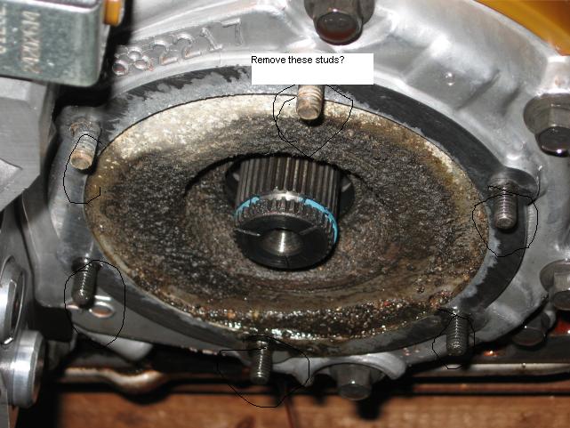

            Yes I am 96buickregal's dad and I'm spending my vacation getting involved in this project. What a thrill. We've got the old transmission out and I'm in the process of swapping side pans. The 95 transmission has 6 studs around the axle seal (see attached photo). Common sense tells me to just remove them. Are there going to be any issues as far as having a nice seal when I put the cast pan on? Thanks for your input so far guys!
              #21
              CRAPOLA!
              Now if I were in that situation i would do the correct thing and swap channel plates... But thats me, and I know what I'm doing as far as going that deep into a 4t60e...
              Channel plates differed depending on which side cover the trans had, stamped steel or cast aluminum. Now for you situation, I'm NOT sure of the best thing to do... You could remove those studs, but I can't guarantee that your tranny even has all the proper gear ranges on it.
              What does your shifter say? P N R D 3 2 1 or P N R OD D L
              If its the first one, then you may have a trans that wont allow you to select 1 for an option. You can test this by seeing how many notches are on the shifter shaft at the top of the case, you can count them with the cover off... thats not a big deal though...
              The NON stud style side cover is a o-ring style gasket, so there is a grove on the inside, now if that grove doesn't line up with where those studs are and will allow the o-ring to seal to the channel plate you should be ok with just removing them... if not you may need to drill those holes in the side cover and use the stud style gasket keeping those studs and pray it doesn't leak.

                  I have the option of selecting "1" on the shifter and both trannys have 7 notches and at least look to be similar. Also the orientation of the shift lever is the same in Park and 1st on both trannys. I measured the diameter of the spacing between the studs and it is about 4 11/16" . The diameter of the o-ring seal on the cast cover is just about 4 1/2" which means the o-ring would rest just inside the holes left by the studs (assuming there would be pressure there when the pan is bolted on). I also checked the distance of the axle seal flange from the case and it is the same on both trannys. I'm going to pull a stud and see what's behind it unless you have more bad news for me. Thanks for responding so quickly.
                    #24
                    Nothing should be behind it except for the 4th clutch outer pressure plate... thats what the channel plate acts as.
                    The o-ring should have enough pressure since well its that design on your old one and mine, It doesnt leak because being cast aluminum there is less flex than if it were stamped steel. As long as that o-ring lays inside of those holes then you should be fine.
                    And it sounds like your all good with the shift chit too... Just remember you use your electronics off the top of the trans so your plugs fit and all.

                      Hmmm, well I've gone in, and with not so surgeon-like precision I lopped off all the studs using a handy-dandy Roto-zip tool with a diamond blade. I know what you're thinking "what a hack!" but they were'nt coming out any other way and at this point I don't have much to lose. I'll have to dress up the surface a little bit but I was wondering if a little Yamabond on the mating surface would help? Is there excessive pressure in this part of the tranny? Any other suggestions for making a good seal? I held the o-ring up to the surface and it touches all the studs on the inside edge. The good news is that the studs are now basically flush with the surface and are still plugging the holes. Time for a beer. I am on vacation after all.

                          I put it back together but I'm just waiting for the weekend so I can get some help putting it back in. It seems like the Yamabond will do the trick though. I had to find another vehicle in the meantime since I've got another new driver in the house and I scored a beauty. It's an '87 LeSabre with 96K on it and no rust. My car dealer buddy let me have it for 5 Benjamins. It's got the 3800 before the Series 1 so hopefully no LIM problems. A little shuddering with the TCC but I can live with it. I tell the kids "just say no to OD". Will keep ya posted...

                                Transmission is in and working flawlessly
