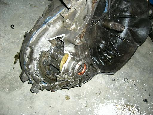

                  • Mars
                    • Apr 2004
                    • 826
                    I have a couple pics of mine :
