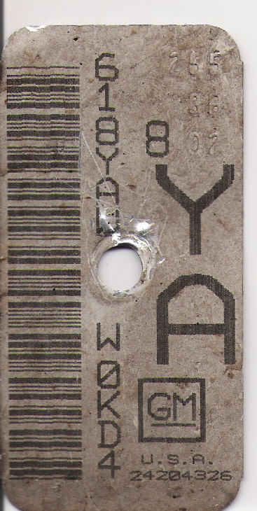

            I'm not sure, I think it was a 97 or 98. Thats why I posted the tag. I need to go out tomorrow and look at it closer. It could be 4t40
            • JohnnyReb
              • Nov 2007
              • 49
              Can anyone decode that tag. Save me a drive to the other garage to look at that tranny? Please
