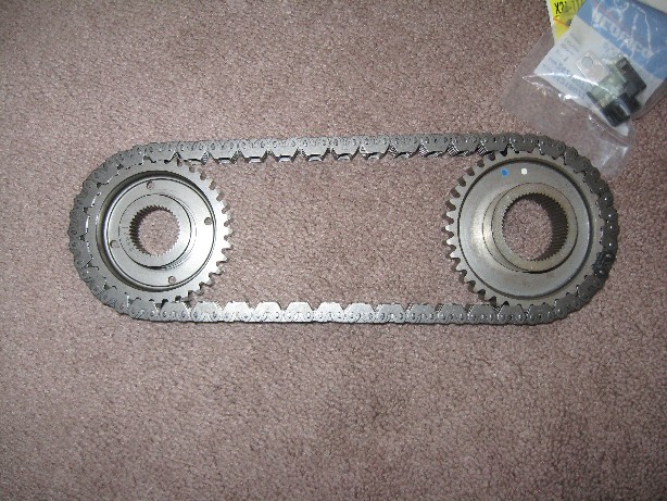

                    Well, the gears, chain and Input Speed Sensor came in today. Already have the billet accumulator pistons.......now if the weather would warm up......

                              Yes, I had the gears changed last fall. It took some trial and error with the PCM (threw incorrect gear ratio codes for a while), but it works well.
                              I still have some things to tweak in the tranny tables. First gear rips through so fast that I still bounce of the 6500rpm limiter if I'm at WOT. Otherwise, I'm pretty happy with it. Didn't really see a huge change in fuel mileage either.
                              I kept a stock-stall converter so as to retain driveability at low speeds, and I run on 17" street tires (needed to clear my 13" front brakes). I refuse to run DRs or slicks, so when all is said and done, that may still keep me from optimal launches.
