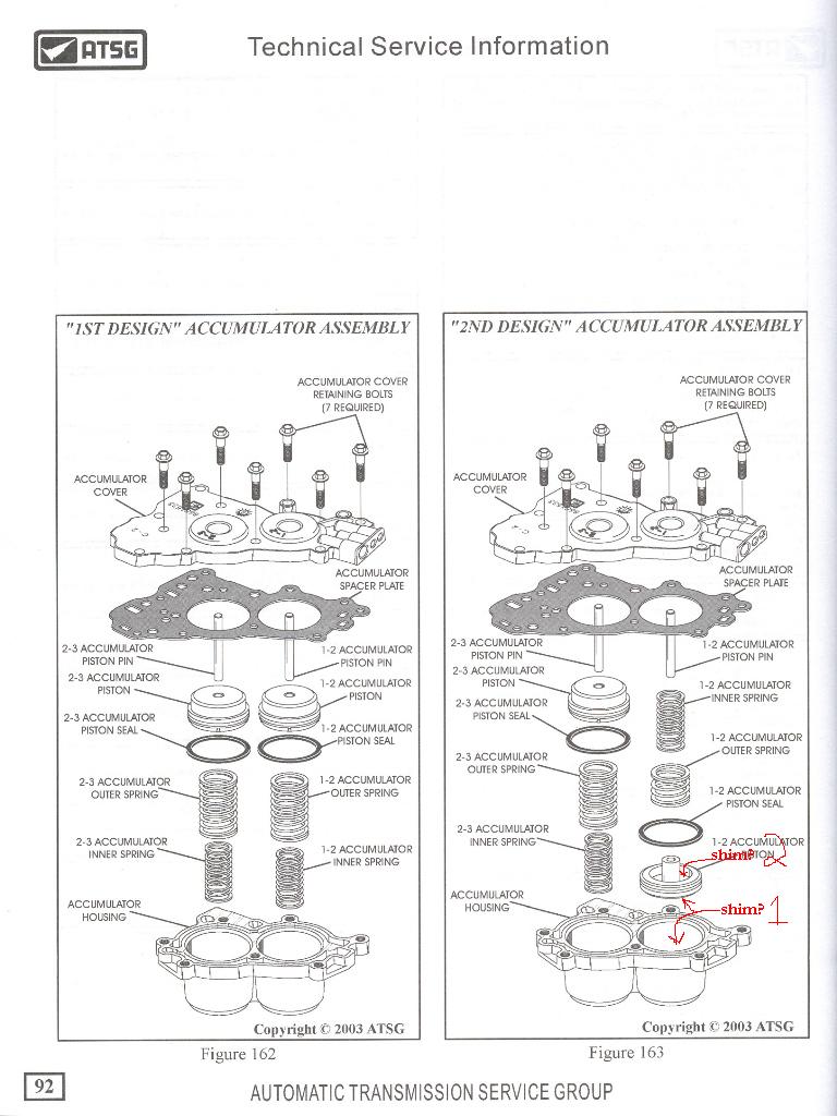

        3400-95-Modified, I found my accum tag thing on my tranny.
        I have the 4AFW....like we talked about on page 6
        http://60degreev6.com/forum/showthre...t=39586&page=6
        what springs do I need to order?...and which design of accum pump do i have ....1 or 2?
          #94
          you have the 2nd design accumulators, so new springs for you would be...
          1-2 outer, 8682700
          1-2 inner, 8668631
          2-3 outer, 8668487
          2-3 inner, 8681456
          Now how you shim the 1-2, I'm not sure on because your piston is in upside down in comparison to mine, Now you could find a washer that fits on the bottom of the piston where the spring rides and just shim it that way, I dont see why that wouldnt work, or you could put them on the cover where the spring hits... I posted the pictures of how they go together somewhere on here I thought.
          On that chart your assy is figure 163

            so, on the 1-2 springs, should I shim it w/ #1 or #2 on the pic I attatched?
            where does the little spring sit on #2 in the pic?....it looks like there is only room for the big spring there....
            and on the 2-3 springs, should i shim on the piston/spring side, or the piston/cover side?
            I wish i knew all the dimmensions of stuff here....cause then I could machine my shims at work to exact specs on a lathe....and not have to run to a parts store in hopes.
            maybe i'll raid a j/y and tear one apart and take measurements then.....time is not something i have much of for that though.
              #96
              Put the shims in the #2 location and for 2-3 you would put them in the #1 location you pictured on the 1-2 accumulator, basically you want to shim on the spring side, top OR bottom of the spring, doesnt matter just depends on which makes it easier and yes they need to have holes in the middle for the center pin to go through no matter what.
