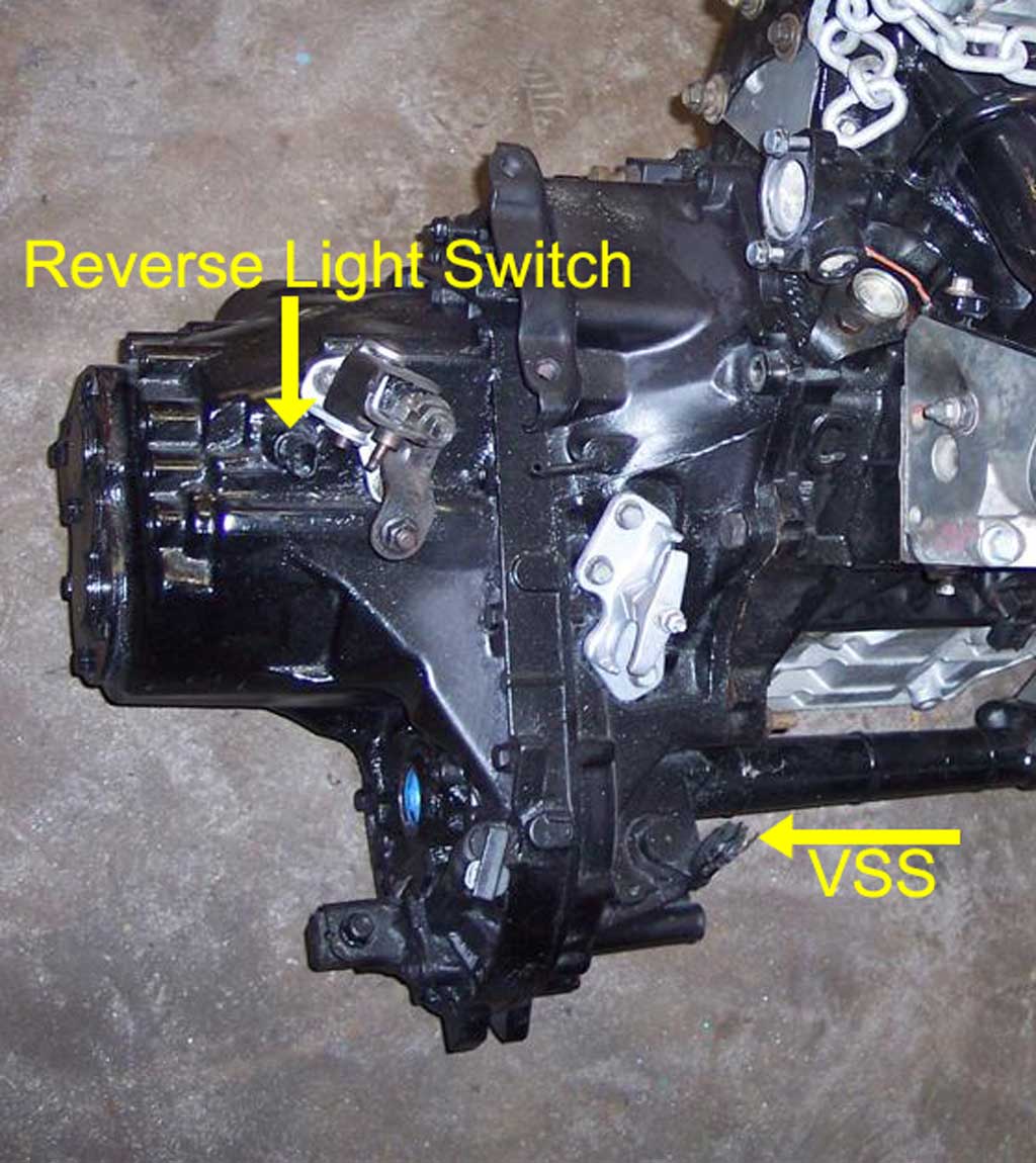

        have a look down at the back side of the tranny, kind of next to where the jackshaft comes out you'll see the VSS. take a pic if you can.

          Found the VSS in the trans, 2 female terminal connector... that isn't plugged into anything. Searched around and there weren't any other connectors or free wires near the sensor.

                With the speedo, I finally found the connector you guys were talking about, there is one that goes into the trans on the top, then the one by the "jack-axle" with the purple/yellow wires. The slices were pretty poor so I fixed those, the connector is pretty messed up too, but should work until I can get a new 1. I re-spliced the wires so it doesnt look like a electrician from a house did it... (he used the stuped twist wire dealies...). Haven't driven it after fixing that. He cut the blue wiring going into the cooling fan and ran a switch to it, was wondering if i were to splice the blue wires back together if it would come on automatically like it should, or if i should stick with the "toggle switch fan operation selector". After fixing the wires I followed them and they go to the automatic shifter (the little module that goes on the 4t60-E shifter ontop of the trans, which he just put to the side). Then two big gauge yellow and purple wires come out, which he spliced together. Are the 2 big gauge wires the ones for my speedo? Or the smaller ones, and they just goes back through the harness?

                  The other connector on the 5spd is the reverse switch I bet. I bet that's not wired up.

                    Wish I could take better pictures, but that's where the harness is and everytime I try I cant really get to how it goes into the trans, can only get the connector itself. The one that isn't connected to anything is on the top of the trans, above the dip stick on the driver side, right by the inner fender/wheel house area. The other one down on the trans is the purple/yellow one.

                      the top connector is the reverse light switch, maybe this pic will help...

                        Yep, the reverse light switch isn't wired up, but the VSS is. Have a diagram to wire up the reverse lights?
