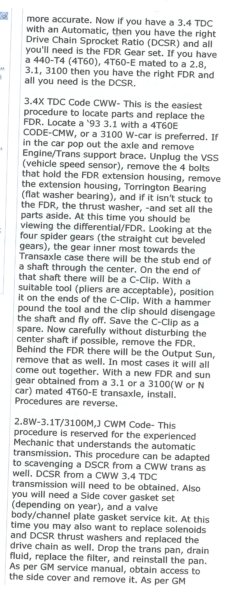

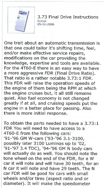

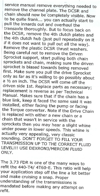

                well, there isn't really upgrades for GM trannys except from GM and that's CHA-CHING!!! I could have change the FDR to 4.10 without touching any chain sprockets or gears for only $1300. this is a good read: http://60degreev6.com/content/4T60E_FDR_Discussion
                there are a couple of guys that make a true LSD or something like it. Engineered Performance so far seems to be a good LSD , but when my tranny gets heat soaked (180-195 degrees) the LSD doesn't seem to do much, but when it's cold, man that thing is stiff! i can torque my wheels with both front tires off the ground! lol there has been an issue with getting the work done there. I waited 6 months for my LSD, others have waited a year. there is a transgo shift kit too. i had a 97 lumina 4T60E. I just added a cooler and an adjustable vacuum modulator to adjust line pressure. that firmed the shifts plenty without maxing out the pump. there's a couple other places, but i can't think of them right now. i have the 3.73 final drive instructions if you'd like them.

                  awesome. hell yea....go ahead and send me those directions dude. id appriciate it.
                  • torq455
                    If I only had money!!!
                    • Dec 2003
                    • 1615
                    see if this works. otherwise i'll send them to your email.
