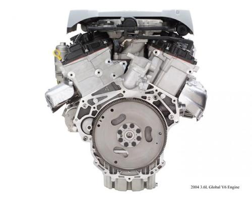

        Exactly right, you are. The published bolt patterns I have seen are the same for all 60* V6 including the Caddies, but if folks here don't know, that makes me, um, less than fully confident in those drawings. Does anyone have a backside photo like above of a high-feature V-6?

          i'm thinking the bellhousing pattern is the same, at least for the FWD versions.
          heres my reasoning: the G6 has a HFV6 in some trims, and i believe it can have a 4t45e hooked up to it, which hooks up to a 3100/3400 in grand ams....... i'm sure some one that actually has one will see this thread and chime in...
            • 9190
            They are the same.

              Does this look the same?
