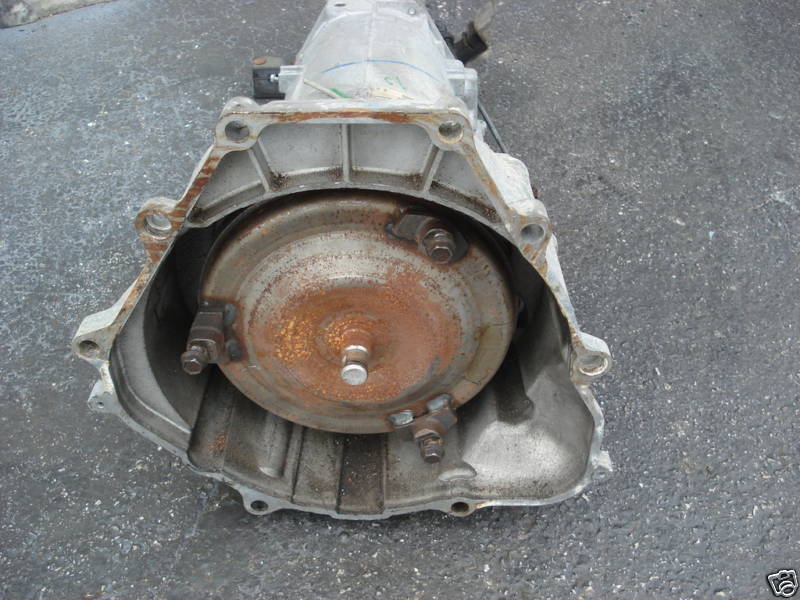

      Well, in my browsing last night, I think I finally found a solution! It appears that the 97+ F-bodies with the 3800 also have the starter on the driver's side. Since the 97+ 4L60E's have a removable bellhousing, I can use an F-body bellhousing and bolt it up to any 97+ 4L60E, including ones from TCI capable of 600hp (Super Street Fighter series). Here is a pic of a 3800 4L60E bellhousing...
        good deal, TCI tranny controller as well?
          Badass!
            • 9185
            But, of course. Well, that is unless someone like FAST comes out with an all-in-one PCM that will allow control of the engine and tranny. I still have several years until I'm to that point, so maybe it will be available when I need it.
            And yes Dave, I was thinking the exact same thing. Honestly, I'm suprised it hasn't come across the site(s) in the past, since its been an option for over 10 yrs now.

                      The Ford Racing S-D T5 is only rated at 330 Ft/lbs. It's great for an MGB but you are looking at more power and a heavier car. I have one in my MG but if I had it to do over, I would probably go with a 700R4.
                      If you go with a manual be sure the check the length of the input shaft length and pilot bushing area. All 60V6s since the LX9 have a shallower hole in the crank and the Ford input shaft bottoms out in the hole. You have to cut about 1/4" off the end or drill the hole deeper.

                            98+ f-body 4l60e with the driver's side bell housing, and swap the valve body from a 93 4l60 (non-e).
                            I actually know a guy who might be selling his in the near future. He is running a 3800 (IIRC) stall and see's 1.8-1.9 60's with a 275hp 3800, and traps a 12.8 @ 105mph.
                            I wouldn't trust a t5 with a car that weighs close to 3k lbs and want to be in the sub 10 second range.

                              As I stated above, now that I found that the 97+4L60E comes with the correct bellhousing, I will be going that route instead of the T5. I will probably just go with a stock one for now until I can save up the +3k for the TCI one. I will probably keep the electronics and get a controller for it so that I can mess with the shifting abilities via a laptop.
