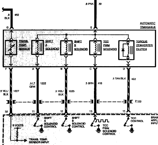

                        The PWM Soleniod for the TCC flakes out very often on the older transmissions. when it does it can cause the TCC to engage poorly or not at all. By disconnecting it the main TCC soleniod will have controll over the circuit. I'm not sure what wire it is, you will need to get a wiring diagram. Just cut the wire or remove the pin and drive the car. The problem should go away. Keep in mind the TCC will engage more noticably.
                        Lorenzo
                          this should help with the wiring... brown wire in the tranny connector. and if you can happen to see the lettering on the connector, it's position C.
                          if you need the diagram for the plug itself, i'll have to upload that too...

                            This is all good info. One thing that is still conflicting is whether or not the TCC will lock up if I cut the connection to the TCC solenoid. I was under the impression that it will NOT lock up if power is cut. The wiring diagram that I have shows that the power for the TCC solenoid comes from a switch on the brake pedal that is intended to shut it off when stopping. This would imply that cutting any wires will cause the TCC to not lock up. The diagram that robertisaar uploaded doesnt align with the diagram I have for my 95. Maybe later 4t60e's had more stuff in them? My diagram shows only 3 solenoids with no temperature sensor. I measured to all of the pins on the connector of the old transmission. I get 48 ohms between two circuits with a common pin (suspect these two are the shift solenoids). Then 10 ohms between two other independent pins. I suspect this is the TCC solenoid. All other pins appear to be open circuits on the old transmission. I still have to test the new one to see if I get the same results. Does anyone know what these resistances are supposed to be?
