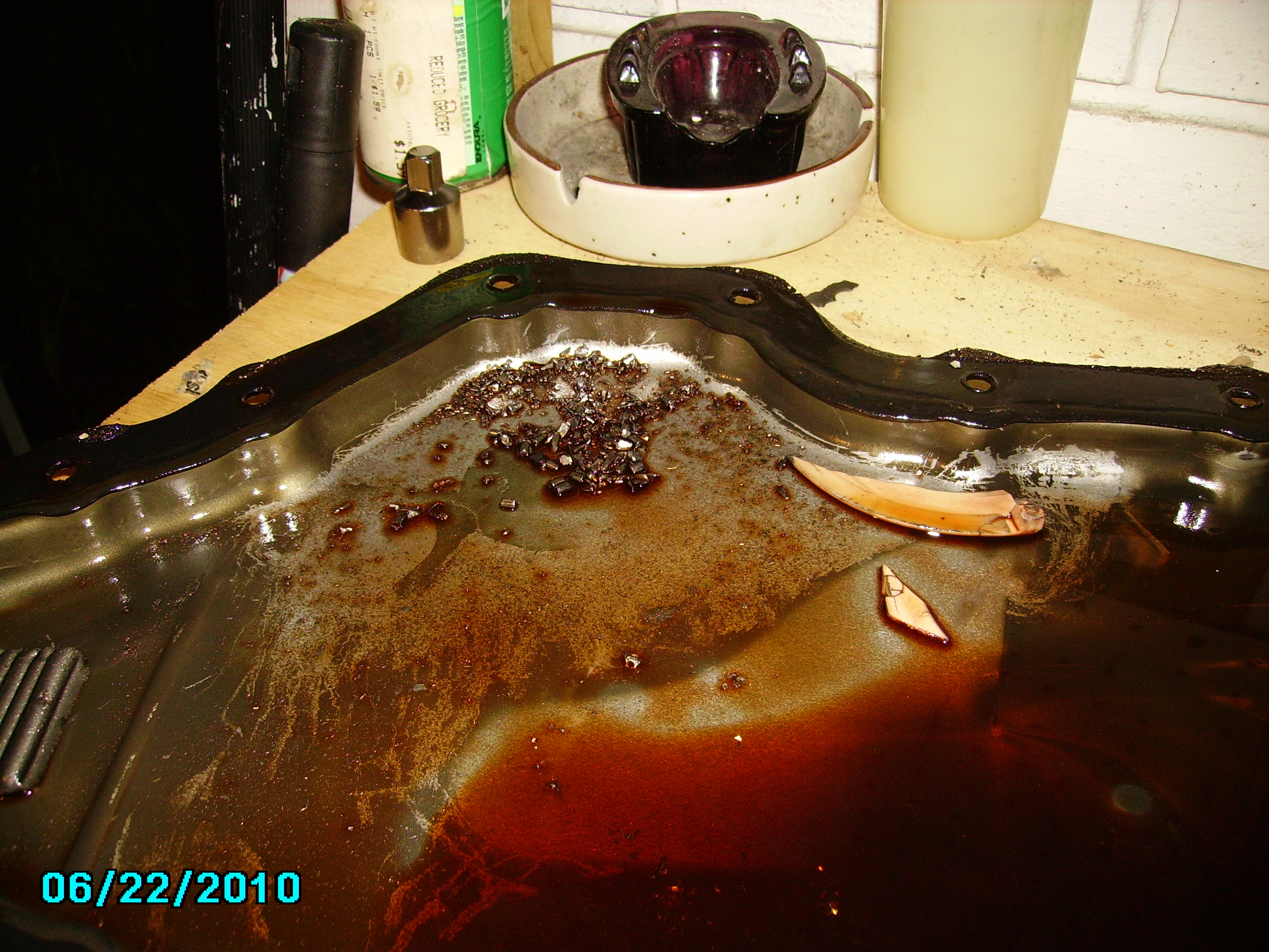

    Hi, long time lurker, first time poster. Usually problems relating to the car have already been answered here but now I have a newer problem that I need some assistance with.
    This is from a 97 Monte Carlo 3.1 with 163k miles. Trans fluid/filter was changed at 60k and 123k miles and has no leaks.
    I noticed a grumbling/grinding noise when sitting idle and accelerating. The noise went away in 3rd gear but came back in 4th. The noise happens when in park, reverse or drive. I decided to drop the pan and found this:
    Metal chunks, small rollers, 2 plastic pieces, and a black film all over the pan.
    Changed filter and fluid, put it back together and it still makes a horrible low pitch grinding noise. The car still drives.
    So, any ideas what those pieces are? Would it be worth my while to rebuild the tranny or throw in another used?
    the plastic chunks may have been thrust washers...
    couldn't say where or what the rest of the shrapnel came from...
    i don't know hom much i would trust that tranny at that point...
      That is the thrust washer from between the 2nd drum clutch, and the driven sprocket support. The other metal is either from that, or a previous part that caused the thrust washer to now fail.
      Do not drive that car anymore, you are now destroying hard parts. Already right now your probably looking at a replacement over a rebuild.

        she is done... driving it will only cause more internal damage and could just give out at any time and leave you stranded and cause more damage then already done. Used trans are hit or miss.... you don't really know what your getting.... if you want a sure fix/repair have it rebuilt if its within your budget. I just rebuilt my 4T60 and got all the updated parts and hardened parts, She shifts better then new (crisp, clean and smooth as butter... AND much stronger).

              Based on what you are saying, you might've busted one or both of the torringtons on either ends of the input sun and did some damage to the pump in the process....Yeah it's toast with all that metal floating around. Don't forget to clean the ends of the axles before shoving them into the replacement unit.
