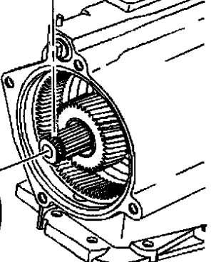

              I pulled both covers off but am unsure of what to count. I've looked for differential diagrams but haven't found any. The reluctor has 30 teeth. The gear on the inside of the assembly (that has the r smalller gears that rotate around it) has 38 teeth unless I counted wrongly.
              And I don't see anything really behind the side pan. What should I be looking for?
                it's been a while since i've gotten this deep in a 4Txx but i believe the two parts you'll have to count teeth on are shown here.
                EDIT: and in the side-pan, you should see a pair of sprockets connected via a dual chain. those are part of the calculation as well.
