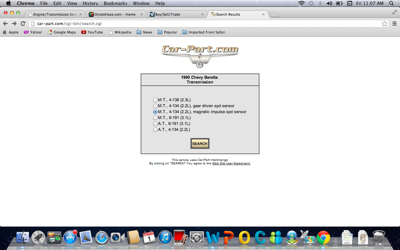

    I need a new transmission so I've been looking at what I believe is the correct 5speed most people swap with. Could anyone verify that this is the one I would be needing? Thanks alot.
Name:	Screen Shot 2013-03-01 at 11.07.52 AM.png

          Most people swap in the getrag 282 (the v6 manual transmission). Some have used the F23, but more use the Getrag 282. The one you have listed is the Isuzu transmission.
