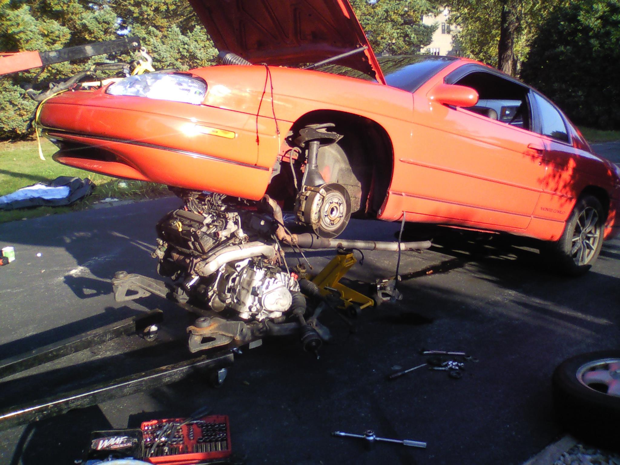

    Easy to drop out the bottom. Pulling out the tops a pita. The amount of time you will waste pulling the axles and exhaust you could already have it all on the ground on a 4 wheel dolly.
      Like this

        Damn. Starting to wish I would have done that now. From what I read its too much of a pain on the ass to pull the subframe without a lift so that's why I'm doing it from the top. Plus I have a Michigan car so I was worried about the bolts breaking. Oh, by the way, that z34 you have there is badass. I bet you get a lot of looks with that supercharger sticking through the hood lol.

          Out of all of the w bodies I've worked on, you shouldn't have any bolts break.
