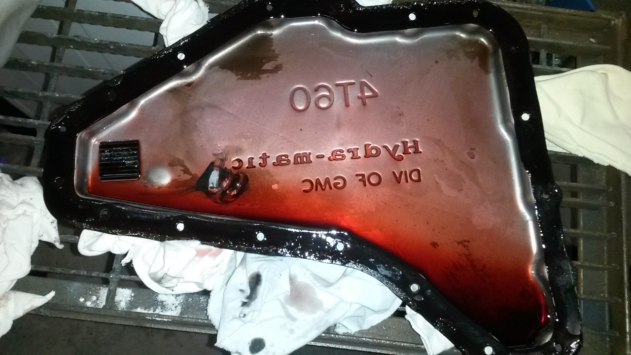

      I also removed the pan, still need to a get a filter that fits, pan was VERY clean and free of debris.
      Something we did notice was the dogbones were worn down quite a bit. Not sure if that would cause the slamming. Ordered a couple new ones, should be in tomorrow.Click image for larger version
