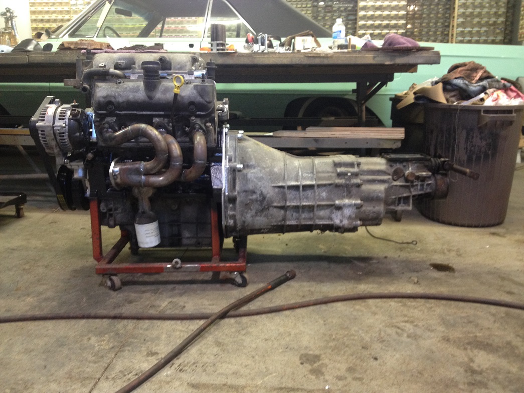

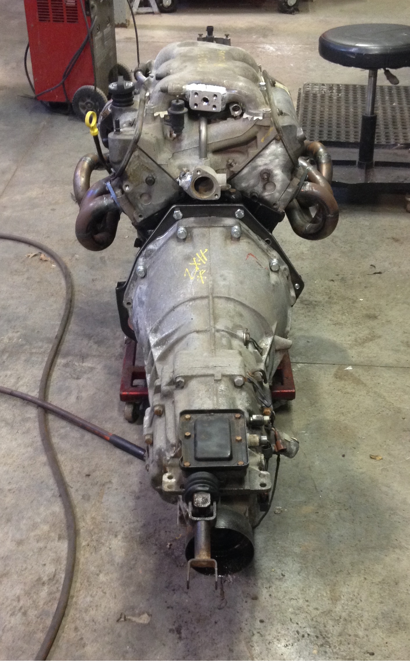

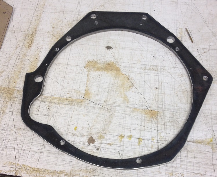

                        Any particular reason you want to use this transmission? Is it what is currently in the vehicle?
                        You can make an adapter plate with enough care and time. This is how I mated an LX9 to a Nissan FS5R30A transmission.
