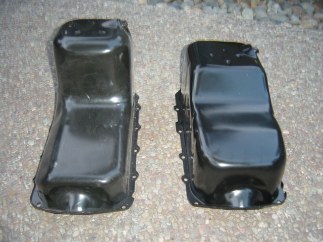

                    S-10 Oil Pan
                    I received the S-10 2WD and 4WD oil pans and discovered that they do not work unless you change the front cover (if that is even possible to do). The 2WD is just as deep as the Camaro pan but may be a little more rounded in the front so it might help but not much. The 4WD would have been better. It is 1" less depth in front but 2" deeper in the rear. The front would have worked great but the overall ground clearance in the MGB would be a problem when it comes to speed bumps. Looks like I'm about to modify my existing oil pan. See picture of the S-10 oil pans:

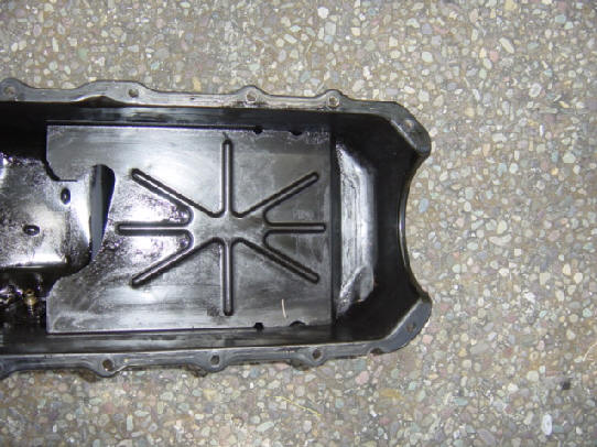

                    This is the inside of the Camaro oil pan. There is clearance to remove about 1 inch (up and back) of the front edge:

                    • Guest
                      Sounds like you may have received an older pan or pans. Pre '86. Do they have angled lips with bolt holes? If they do, you have older pans.
                      The newer pans ('87+) all have a pressed seal in this area and can be swapped between engines.
                      *edit*
                      I just looked at your site and it says that the engine was isnatlled in an '84 S-10 previously, which most likely means that the S-10 front cover was used, if it differs from thr new pans. You would be better off, swapping to a newer front cover, since the pans are easier to find, you already have 2.
                      The only "problem" in doing so is that the water pump is a reverse rotation on the newer 660s. Though I'm still not convinced completly that you don't have the F-body front cover since you mentioned that you needed a spacer for the pulleys, which I can only imagine being for the water pump, since that is shorter in the F-body.
