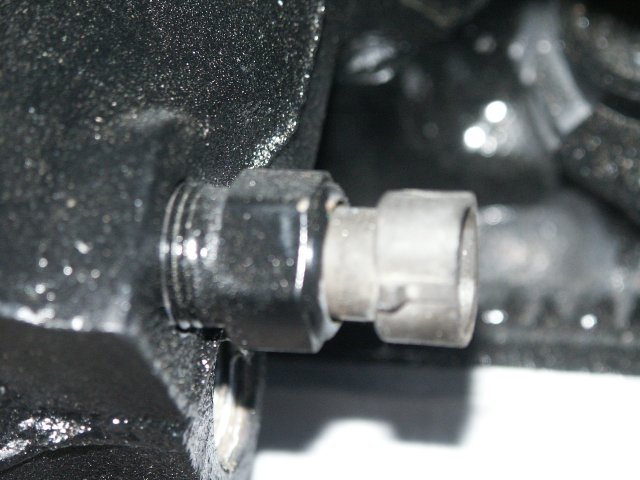

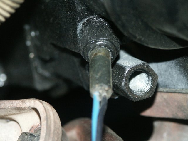

                        Hopefully the pics come through...
                        The first one should be of the sensor in question - the blue wire is definitely blue...
                        The second one os of the sensor in the LIM - on the original 2.8 in the car (a Fiero) this sensor was for the dashboard only (gauge/light).
                        On the original 2.8 engine, the ECM CTS was a single wire unit.
                        I am having a lot of fun figuring out all of this stuff without a real manual - of course, I have about 5 different cars frankensteined into my Fiero, so a manual wouldn't be all that much help...
                        Thanks!!!

                          That first one is deffinantly the coolant temp sensor for the GAUGE. I have never seen one with 2 wires before. Normal stock is 1 wire that is either GREEN, or PURPLE.
                          Hard to tell from the second pic, but I am going to guess that it is near the thermostat area? That looks like the coolant temp sensor for the ECM. which is normally 2 wires.
                          If you can get a picture of even both of them pulled further back, I can confirm this.
                          On the first pic, the sensor lookes like it is next to a head bolt, so that is how I figure it is the coolant temp sensor. I still need to get down there and take a pic of the one on my STE for you.
                          Just so you know, you can get a sensor from a 1996~ish 3100 car. It is a 3 wire one that uses a connector like the TPS. I used that one on my STE becasue my single wire one was bad. It will screw right in, and I only had to run 1 wire and solder the other 3. Might want to consider doing that. I will try to get a pic of that as well.

                            I can try to get another pic today. However. I know for certain that the second pic (the CTS with just the male plug on it) is for the gauge/idiot light.
                            I have already tested it in the oven
                            I didn't want to toss the one with the wiring pigtail in the oven, for fear of melting the insulation.
                            Great Idea! A pic would be excellent.
                            It looks like that due to all my mixing and matching of parts, I have two sending units that are for the same thing - i.e.: the gauge/idiot light.
                            If I can find one of the 3100 3-wire CTS - that would be great, I really like as few wires as possible!
