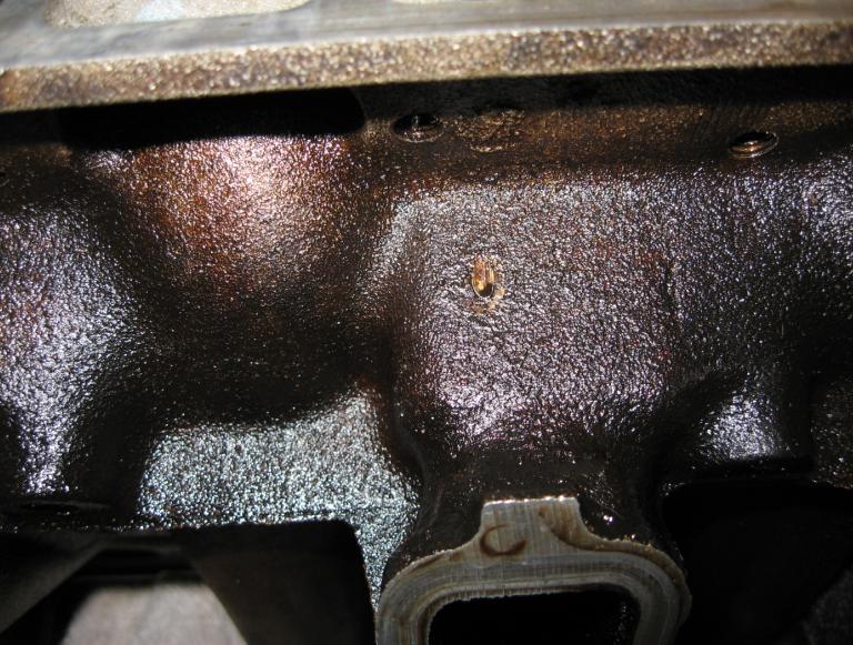

    Found this on my old 3100 intake manifold. Everything was stock and obviously it had rocker clearance issues at some point in it's lifetime.
    Looks like when the valve was closed the rocker was binding up on the intake manifold, possibly keeping the valve open partially. I guess it finally wore it'self away though...
    Check it out. Discuss.
    EDIT: Not from the rockers. No rocker is anywhere close to that mark. Someone must of banged it on something before putting it on the car...

    That doesn't look like its in the right spot for clearance issues...
    That is my 3400 manifold when I installed it with the stamped rockers. If you look at where my notches are in comparison to the ports, yours are about an inch more to the side - centered on the port. Makes me think thats not from a rocker...

      This is a small port 3100 LIM. Not 3400. Notice how the 3100 has bulges under the port opening to the head where the 3400 doesn't? I don't think it could be anything else to cause that wear pattern...
      I will take a picture later to confirm. It's on the backside of the motor.

              I have have to go down and bolt a small port lower (do I still have an intact one?!?) to one of my heads. The point I am trying to make is, with the splayed valves, I'm not sure where your nick is, is a location where a rocker is.
                • 9190
                Ok, so I went down and assembled my hacked up manifold to a head (too bad the batteries in my camera are dead!), and there is a rocker directly under that port. Man, its been too long since I've really messed with these engines...
                But, again... your's almost looks like more of a sharp nick, where mine is a smooth gouge. Of course, with mine, it wasn't something that just happened out of the blue with the engine running... lol.

                But again, where your nick is, is from the opposite rocker, where there shouldn't be a clearance issue from what I can tell. Unfortunately, I only have roller rockers in the basement now, so I can't look at how the stamped rockers fair..

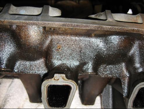

                    Ok, you're right Brad. I thought that maybe there was another rocker in that area, but that area with the wear mark is right between a huge space with no rocker in front of it. BTW Brad, that's not the kind of powdered metal you want your engine to be made with.
                    Very odd though, as something hard had to of hit it, because the metal is pushed/smeared downward...
