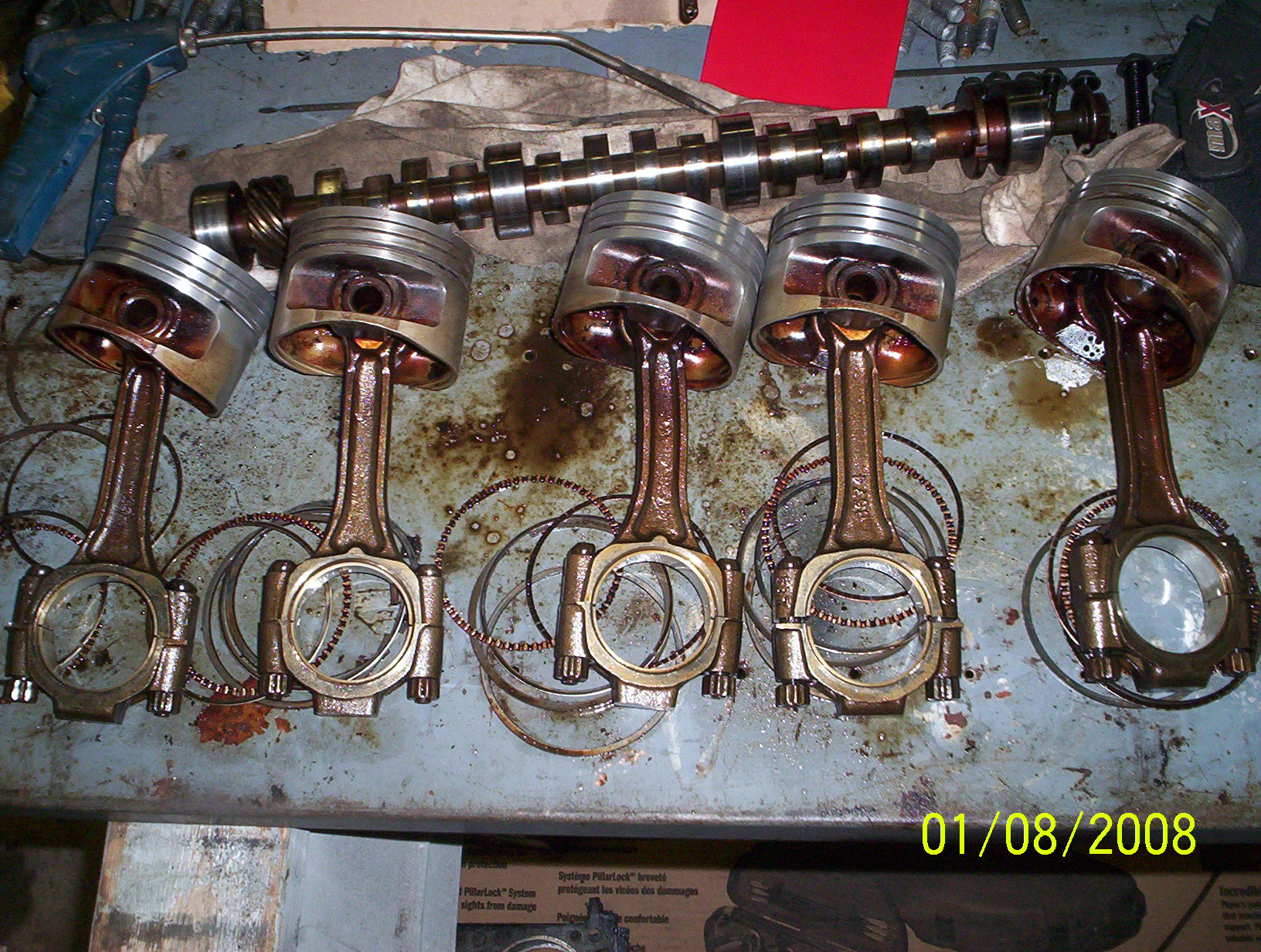

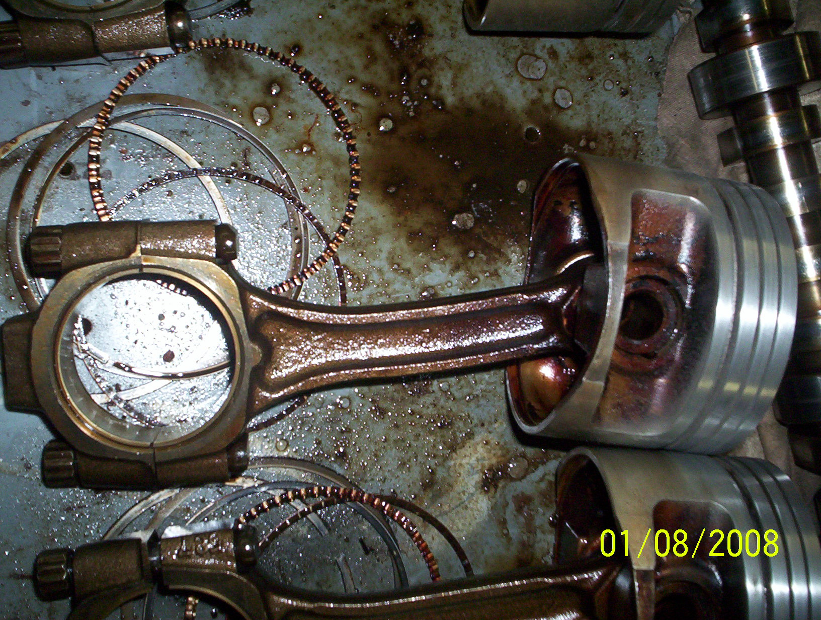

    heres my cam ForcedFirebird, and my bent connecting rod..

      How'd that happen?
      I have 5 extra rods from another engine, but need to press the piston off before I can let it go. ARI sells rods for about $20, though.

        you know the engine ran fine before i tore it down.. not one funny or odd noise.. it had oil all over from cheap leaky gaskets so i tore it down to change gaskets.. well decided to check the rings and pistons, timing chain and sprokets, and decided to pull the cam for the hell of it.. well just today i found the bent rod and pull the pistons out last friday..
        the cam has grooves in it and the cam bearings are bad.. i have a 3.4 DOHC block and hopefully those rods are good if not u will be hearing from me..lol
        Just let me know about the cam.. im looking around for one and trying to get it on the fast side.. im trying to get this motor together so i can get on the road..

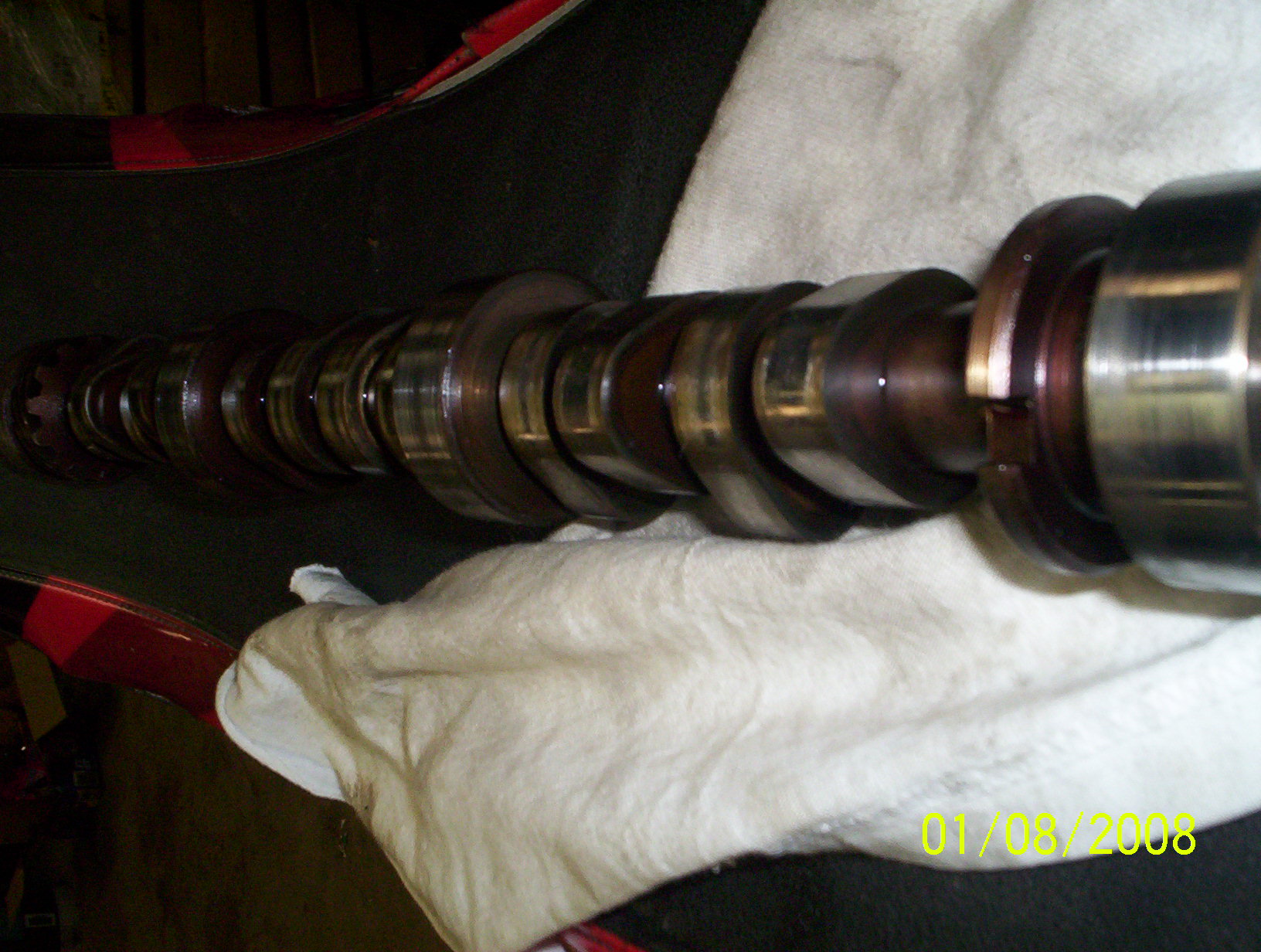

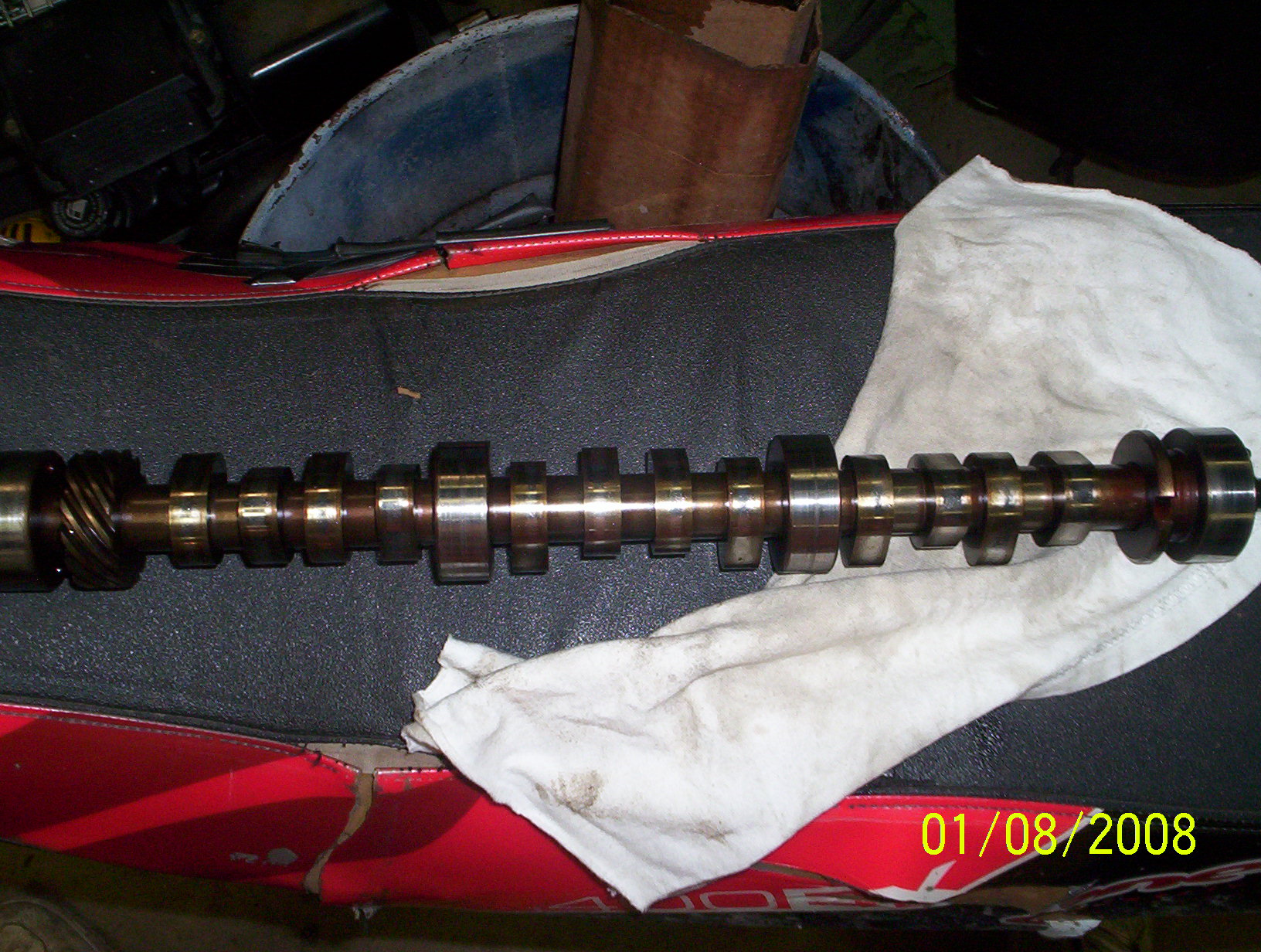

            Here's a pic of the cam and timing lobe. It looks like the 3500's have a 50% lobe and yours is just has a notch. The 3.4 SFI's have justa a tab on them. Wonder why the changes from GM?
              • 9190
              This has been discussed many times. The pickup is different, by the sensor still picks up the leading edge, which is in the axact same location between all 3 designs.

                        yes sounds fair.. the only thing i ask... look in the picture of the 3 cams next to each other... i think its the angle of the camera but the way the cams look it lokks as if going to the right the cams get smaller?? i need a second opnion.. also the cam is in good condiotn.. able to run it?? pm me where i can send paypal payment

                          Its the angle of the camera. They are all the same size.
