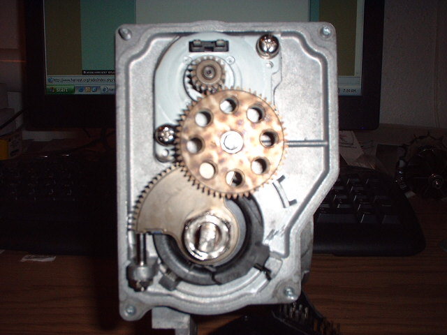

    Anyone besides me think of taking the electric throttle bodies found on the new motors and making an electric exhaust cutout? Aluminum has a melting point above 1200 degrees and I doubt it will ever get that hot a good distance past the converter. So far my EGT gauge hasn't registered 1000 deg at the exhaust manifold from what I have seen. I run two EGT sensors about 3 ft apart and they usually read about 150 deg different although some of that may be due to the sensors being different. One signals the gauge and the other is for datalogging.
    I noticed the units sold for this task are mostly aluminum.
    The throttlebody motors are two wire units as can easily be seen once the cover is removed from the throttlebody

      Stepper by way of varrying resistance electronics, I just tested the motor itself with a 1.5 volt AA battery and it runs like a typical electric motor although slow due to the low power input.

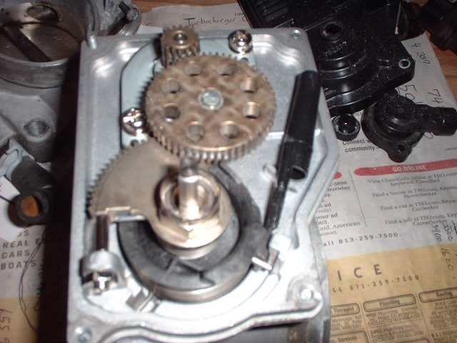

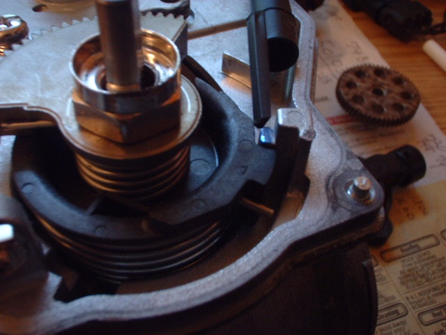

                Actually cost wise there's no comparison to purchasing them. I have the throttlebodies as left overs along with exhaust tubing, a welder and plasma cutter. This is enginuity driven. The easy way would be the cast iron manual cuts from JC Whitney for $40 ea. If you are referring to the stock stop that prevents the electric TBs from closing I've modified one to allow it to close completely.

                      How did you get past the stock partially opening issue? What modifications were made? I havent cracked mine open yet. It's still got the stock harness on it with all 10-15 wires still.

                        Grind away the area with blue coloring indicated by the pin cap and it will allow the throttle to close completely, note once the cover is removed there are only two terminals to power the motor.
