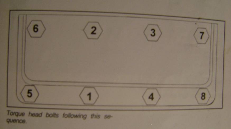

                    This topic of coolant leaks has been popping up more an more. Without impugning any other source for the head gasket installation procedures... the attached images cover this treatment in some greater detail than the typical Haynes Manual that might prove useful. I keep wondering if either the quality of the head gaskets is diminishing or that they are being inverted or installed on heads that are simply not up to the standard of being within a flat and level state of at or under .003 inch deviation from being perfectly flat. As for the torque sequence and pattern, since there are only four bolts per cylinder, approaching "squeeze" perfection here seems critical in getting the heads to lay down and stay there. Here are some photos on the subject..
