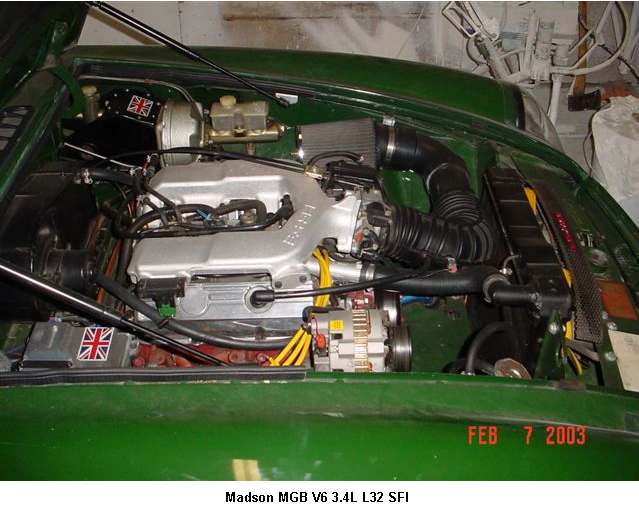

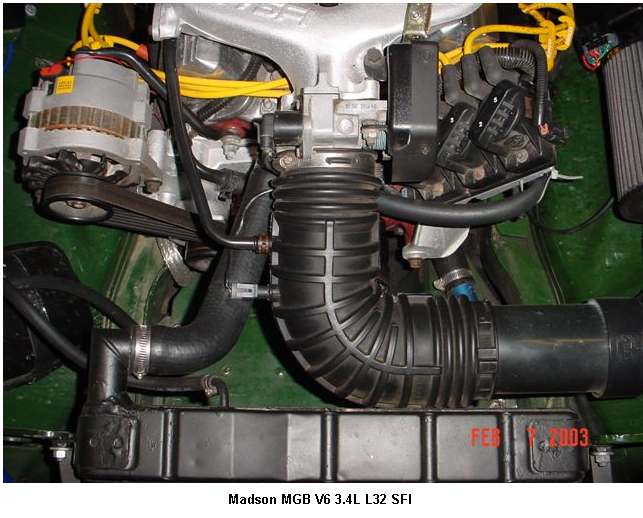

                Drop in on Brian's image of Mike Costello's great photo lineup on this very project...using the L32 as well. (Click on the link to see the other 'Build-In-Progress" images on the right side of his page)
