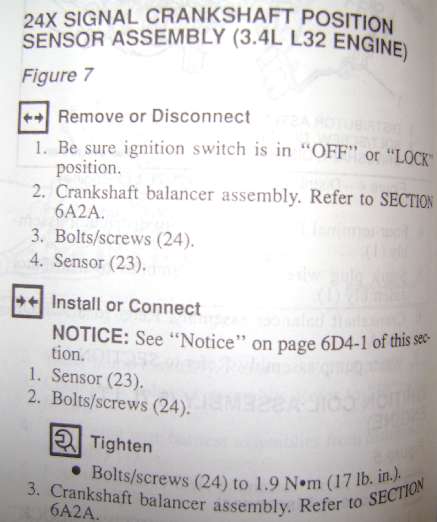

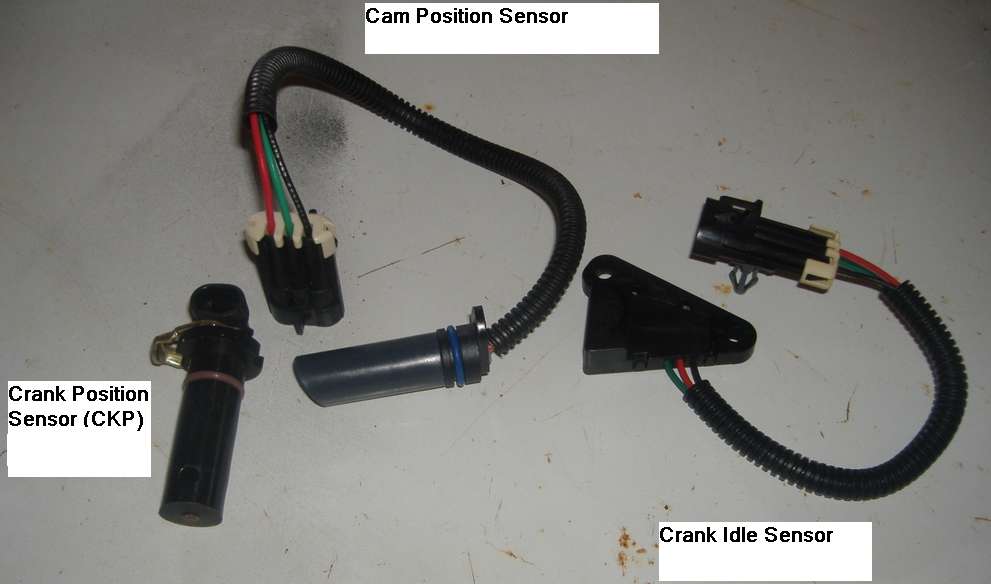

                            sprucegagt has it exactly correct. But to elucidate the subject... here are two links to forum discussions that cover all the variations on the themes of what sensor is supposed to do what...( I know... I get the 3X and the 7X mixed up all the time, too) and the symptoms that arise when they misbehave. The attached photos are from the 3.4L engine sensors for the 93-95 F-Body...so your arrangements might differ slightly. Here you go...
                            http://60degreev6.com/forum/f100/no-spark-t43677/page2
                            http://camaroforums.com/forum/archiv...p/t-28644.html
                            http://www.automotivehelper.com/topic535109.htm
