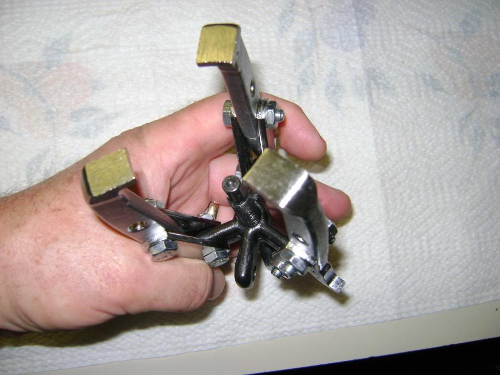

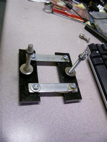

                I got bored and made this at work today.. going to try and use it in combination with my regular harmonic balancer puller tonight. The black plates are 1/4" steel and the silver ones are 1/8". It's adjustable a few different ways so we'll see what happens...

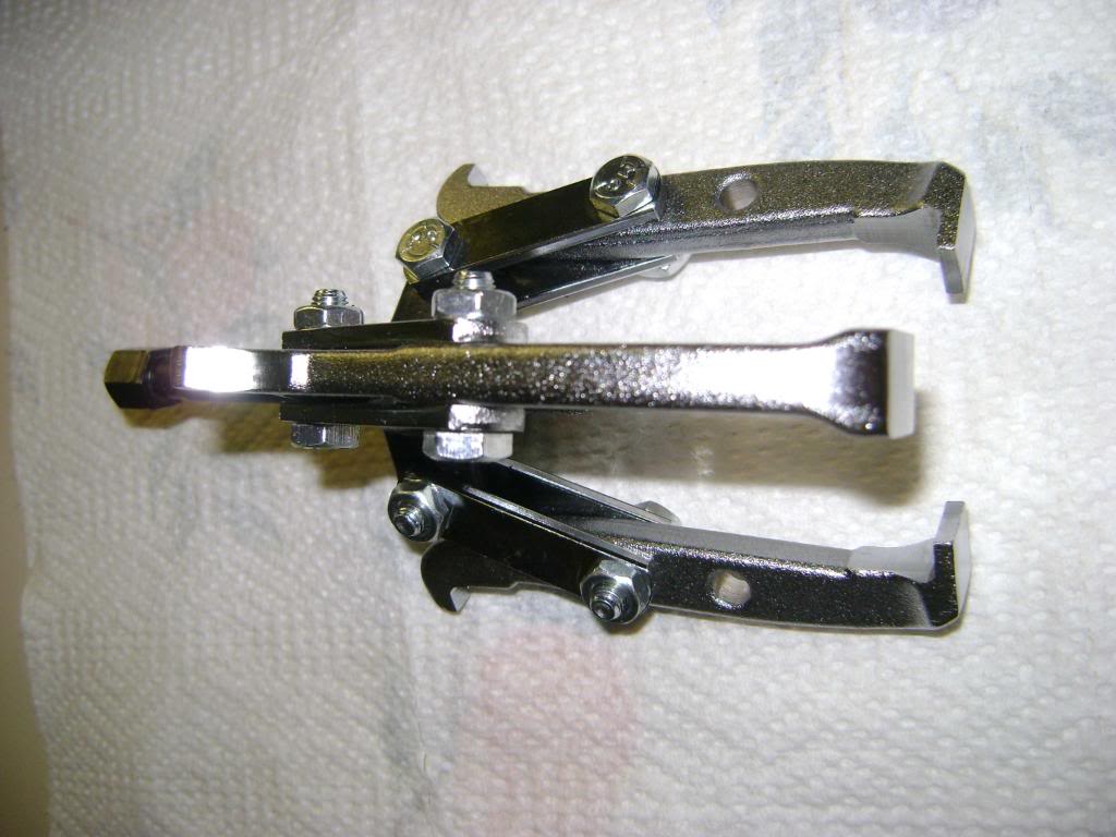

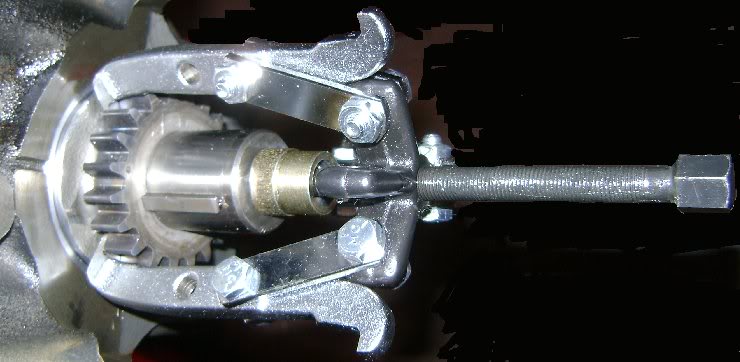

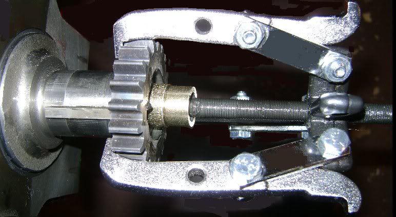

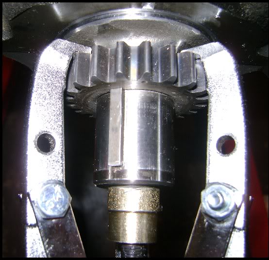

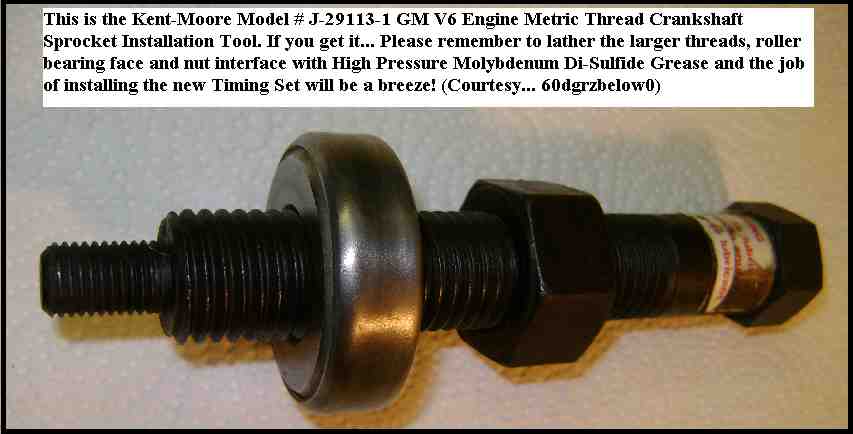

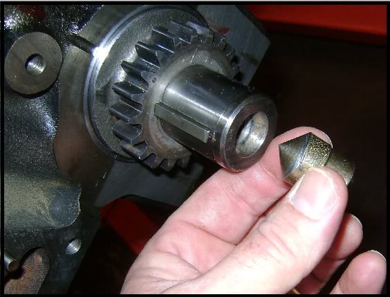

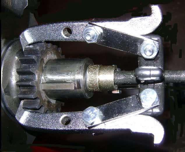

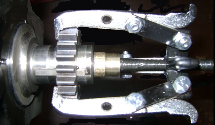

                  Dave's design is a very clever one. Here are some additional images of the Three Prong Tool suggested by him and Geoff as well in action and the Crank Sprocket Installation tool from Kent-Moore to get the new one back on. Accidentally pounding on the end of the crank can de-tune it, so a short length of galvanized pipe extension from AutoZone and the side of a large plastic mallet can be used to pound it back on until it destroys the impact end of the pipe and finally bottoms out for proper alignment will finish the job nicely. Like vengeance...this is a mechanical fix that is "Best Served Cold" as introducing concentrated heat on the assembly might cause the oil in the block to congeal and plug up your Oil Pump Screen or even compromise the strength of the metal parts being heated incidentally in that area. A swipe of Moly-D grease on the crank nose just in front of the small gear will allow it to slide off with the use of the tool and drop into your hand like an Oreo Cookie into a Glass of Milk.

                      Yes Max... I went out and rifled my specialty tool box and snapped the attached image with the proper PN and description.
                      To Whom It May Concern...
                      This tool... (if it is identical to the one Max has)... has a small, metric threaded bolt that should be screwed in snugly inside the nose of the crankshaft and while holding the new, small cog gear aligned with the Woodruff Key...(and with plenty of Moly-D covering the larger bolts threads and mating surfaces between the hex bolt and the outer face of the roller bearing that presses on the outer facing of the gear)...You can then slowly (and almost effortlessly) tighten down until the cog bottoms out in the ogive curve of the crankshaft... a short length of galvanized pipe slightly larger than the outside diameter of the crankshaft must be used in between the cog gear and the inner race of the bearing after the small gear is initially pushed onto the nose of the crankshaft. This will properly align the small cog with the larger camshaft gear which should be installed with the chain after this part is completed. It sure "beats" giving any new parts a "beating" to get them installed. Oh...and this is also the prescribed tool to use to easily install the Harmonic Balancer, too... without the pipe section in between...of course...

                          My contraption worked well after i took the grinder to it and narrowed it down a little.
                          too bad i found out later on that the crank is junk

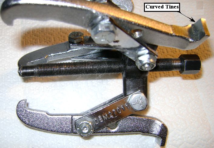

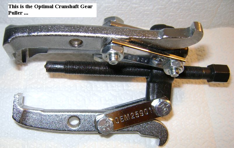

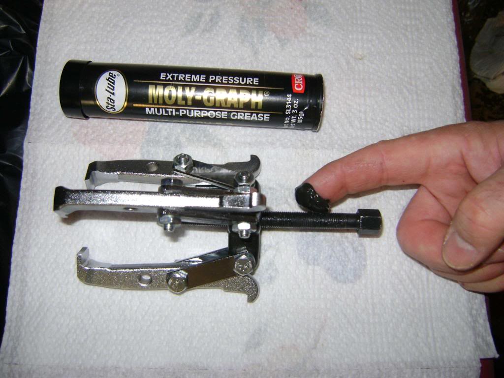

                              Here are better descriptions of the two pullers that will work for the Crankshaft Gear Removal, should anyone want to find them online and get the right ones for the job... (See attached Images...)
